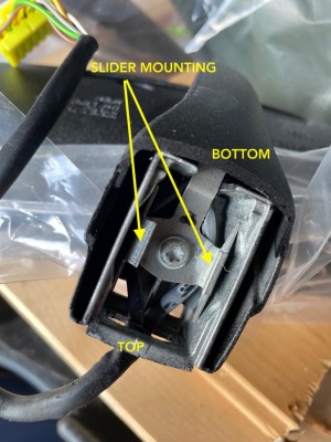

Study the pictures to work out exactly which way you are sliding the mirror and you will find it isn't as bad as you think. Good luck.
