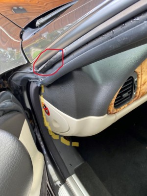

On returning to the car I found water dripping down the near side, down between the door and the end of the dash (see yellow trace on the picture) and into the footwell.
This has only happened once before when the car had to be left outside for 2 weeks.
When I use a low pressure hose to wash the car it is no problem.
I have attached a picture of the problem area.
Also the area highlighted in red looks to be different from the off side, in that it flares out differently.
I am pretty sure that this trim has been off before my ownership.
As these door and window closures are rare and very expensive I don't want to just throw parts and money at the problem without doing some research first. Does anyone have any experience of this problem area?

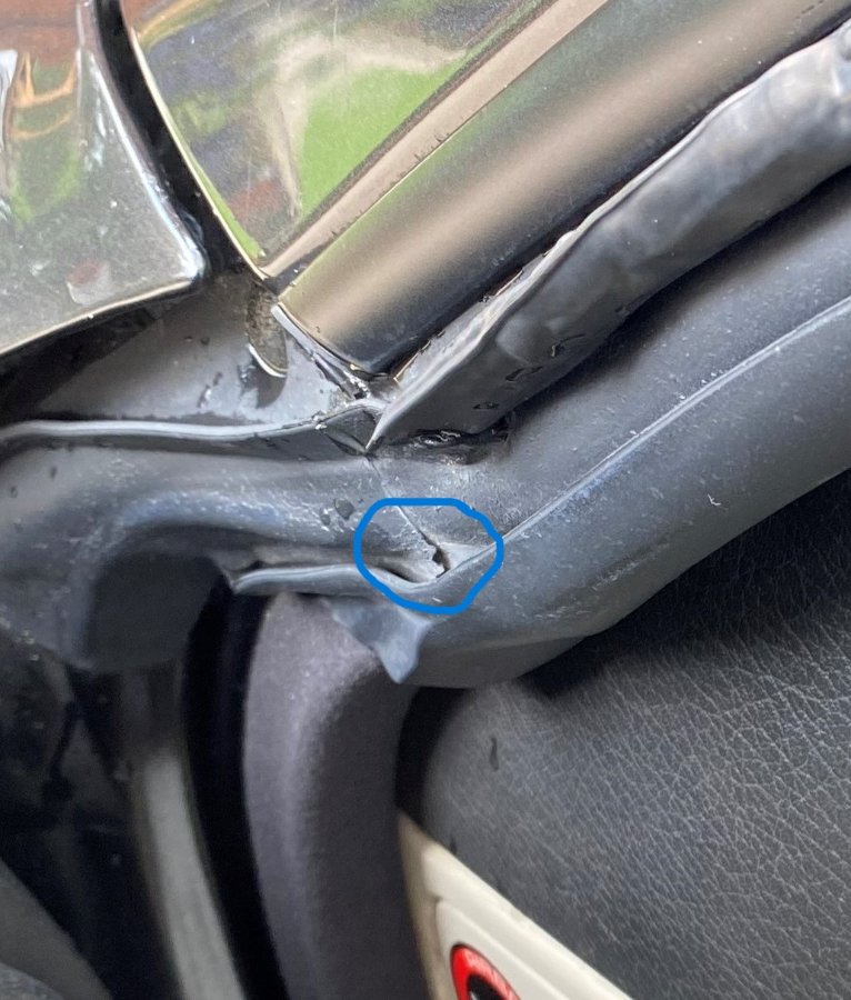

You are quite right about the holes.
I have highlighted one of them. I already tried poking a thin cable tie down this hole on both sides,
Probably as expected the side that doesn't leak allowed the cable tie to slide in a long way without problem.
On the near (leaking) side, I had to manipulate the seal a bit to allow the cable tie to go down the hole beyond a few mm's.
So this may be a good clue. I will do some more work on it and let you know.
