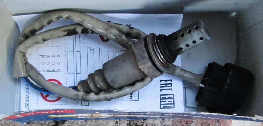

I put my hand in my wallet and buy a replacement sensor off the 'net, from a "trusted trader" mate in London. Fit sensor and use car, all lights out but keep getting restricted performance issues. Also the car develops an offbeat tick over plus a "plucking" feeling on take off which can be overcome by booting it ! :shock: Also the righthand exhaust pipe develops a lot of rust in the outer shell leading to the possibility of a blown head gasket... or is it.?
I pull everything apart on the intake side checking for hose leaks and a few more things beside.... no codes by the way.
Still no joy and the average fuel consumption is 14mpg :roll: and before anyone says it i didn't buy the Jag for its fuel consumption figures but it does illustrate the health of the engine quite vividly. to back that statement up I run a Honda 3 litre V6, a TVR 4.6 V8 and an S2000 as well so I don't expect great mpg !! :lol:
I whizz the car up to my mates MoT garage and stick it on the emissions monitor.....green across the board...sensor appears to be working but whilst there I hook up my code reader and go into real time readings... the short term fuel trim is all over the place along with a few other associated readings including fluctuating sensor readings.
Eventually, a few days ago I decide to retrace my steps back to the sensor change... I get the car warm /hot, turn it off and disconnect the new sensor... hot so that the engine doesn't "feel" the change without it. On start up gone is the 7 cylinder feel and the plucking disappears too, the fuel consumption improves to around 18mpg ...
I do a bit of research on the sensor, to discover that there was a change in '98 and again in 2002 to the sensor type. My car is 2002 but the chassis number comes before the change in 2002 (also engine moves to 4.2 just to compound the problem.)
I ring Neville and come to the conclusion that the previously supplied sensor in a "one size fits all" is NOT the correct one ! :roll: no matter what the previous supplier claimed. Neville advises that the Denso one is the correct version for my car and not a spurious copy !
This afternoon I fit the new sensor, five minute job, take it out for a test run of around 15 miles on country lanes and 50mph dual carriageways.... RESULT ! Not only has the plucking and offbeat feel gone but it PULLS LIKE A TRAIN :lol:

Sensors. Yes, it can be a minefield selecting the right units. Differing threads, cable colours and plug shapes and sizes. I have one here I can`t use for my XJR which was incorrectly supplied by Gendon. They won`t take it back because I`ve opened the packet!
The next one came from Manners. Perfect first time. As I`ve frequently said on the X350 section, buy only genuine Denso and from an OE supplier who has knowledge of the differences and relativity to model years. The Manners phone service was exceptional in this respect.

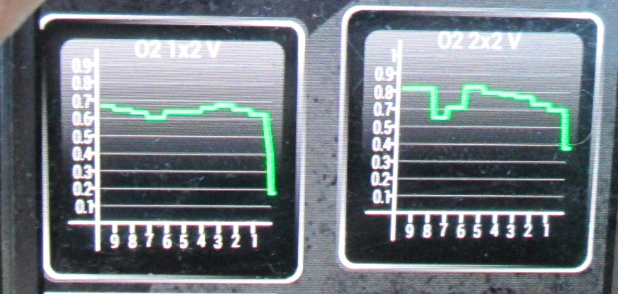

The reason I had to change a post cat sensor on the near side was because PTJS1 and I found it flatlining. Normally they run at around 0.7V. Paul and I rigged up my Android phone, Torque Pro app and an ELM327 bluetooth chip into the OBD port. Then we set up a trace from both sensors onto the screen. Bingo straight away! There it was for all to see. Near side rear sensor frequency plummeting like a stone. Installed the new Manners sensor and things improved dramatically. Fuel consumption down, reduced stink at the exhaust on cold start, better running etc and a similar trace to the off side unit.
These sensors and there performance are vital to the car. Some may remember an MOT issue I had in Feb 2017. The car only just made it through the test due to high CO at 0.19%. Had it been 0.20, the car would have failed. We had to rev the engine for five minutes to get a just about acceptable CO level. Initially I pointed at the 200 sports cats fitted as a culprit. The issue was a constant worry as I feared having a repeat performance at the 2018 MOT. Then Paul and I got the Torque Pro app going which enabled us to watch what was happening in real time as the car was driven. It was then we found the duff sensor. Once replaced, the car flew the MOT this year without any issues at all. Phew! CO now at a rather more acceptable 0.14% and no problem at all at the test.
Here is what we found with the Android/Torque.ELM set up. Note the left hand screen which was the near side sensor trace that would flatline and cause all the grief.No problem at all now.
It is worth noting that if you diagnose a PO430 or PO429 code, the message will probably say something like "Bank B, catalytic converter out of threshold limits". This DOES NOT imply the cat is shot. I just points to the fact that the cat may be out of limits but it is MUCH more likely that you have a Lambda sensor issue.

Interesting that regarding the voltage... "The reason I had to change a post cat sensor on the near side was because PTJS1 and I found it flatlining. Normally they run at around 0.7V."
My "new" version, one size fits all :roll: actually showed 0.74 v (bank 1) and the other bank, which are far as I can tell is running fine, 0.09 v when hot.
I haven't had the scanner hooked up yet with the Jag Spares part fitted but will do in the next couple of days... be interesting to see what has changed...

Your sensor might have just been within acceptable limits and not have been bad enough to cause a full blown Lambda/cats out of limit code. Its much better for the sensor to fail completely rather than be just about acceptable. If its fully duff, its much easier to find!
The scan shown in my post makes interesting interpretation. Accept both sensors never show identical traces and that there is apparently some sort of switch over which takes place from time to time. What you see on my trace is just after a start up. The right hand trace is typically what we are looking for. The left hand trace is less lively initially but then plummets sharply downwards. Sadly I didn`t take a shot of the flatlining. Had I managed that, you would have seen that duff sensor trace bumping along on the bottom of the graph and taking time to get back up the hill to a more plausible 0.7V.
