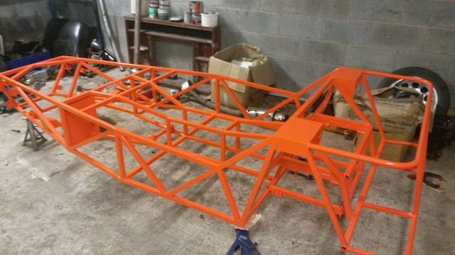

decision has been made , cuz i just bought it online, lol
its a Haynes roadster chassis , custom built for BMW 318i parts , including its Fi engine and 5 speed manual Getrax box , all fully fitted to the frame already ( all electrics included )
custom built intake manifold , and full independent rear suspension using the BMW diff , and four brand new BMW wheels
the frame is fully power coated after a professional build with custom mounts for everything
no body at the moment, just running gear , this is not going to be a 5 min project ( for those that dont know me )
i am going to build it with my youngest son who is 21
pics to follow as soon as i can

Brakebuster
Posts:3145
Location:Gloucester UK
Re: I'm going to build a kit car.......
Postby Brakebuster » Thu Jun 19, 2014 4:50 pm
thanks lads,
i managed to get the lot for less ( much less ) than a fully welded up new chassis with no coating ( £650 )
so all running gear , engine and gearbox with diff etc its a steal ,
turning up tomorrow ,
he offered to deliver it for the cost of the fuel.........how could i refuse
BB

Brakebuster
Posts:3145
Postby Brakebuster » Thu Jun 26, 2014 12:24 pm
quick update
the engine and gearbox are in and the front and rear suspension is built up , i have refurbished the steering rack and am waiting for some brackets to mount it ,
the front of the car is on its wheels, and the rear is waiting for a spacer before i put those wheels on
BB :mrgreen:
