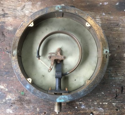

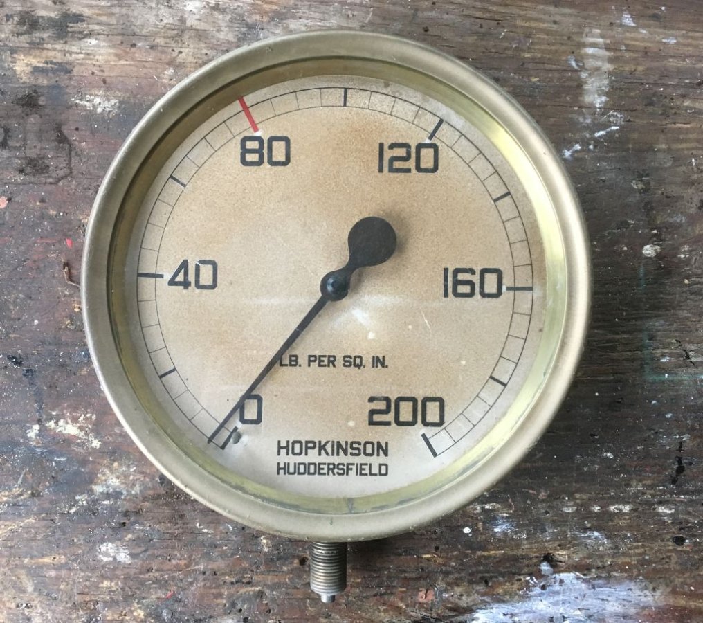

As well as caring for the XJ-S, I keep busy in my own workshop doing odds and ends. A while ago I found an old brass steam pressure gauge in an antique/curiosities shop which I bought.
Not being of much practical use I thought I would turn it into something more interesting.

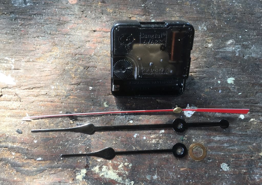

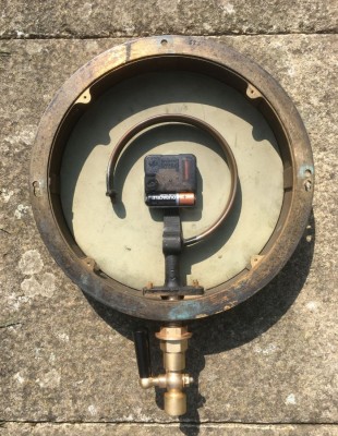

Once completely stripped down I measured and bought a quartz clock mechanism and hands for £6 on eBay. These things are available in many spindle lengths and hand designs to suit all sorts of conversions.

I had to drill out the centre hole and shorten the hands a bit, all the brass was cleaned and given a spray coat of lacquer to stop it varnishing. My normal brass cleaner is a paste of white wine vinegar and copper polishing powder, clock makers often use a magic substance called Horolene which makes a lovely job on delicate brass but is quite expensive for large items.

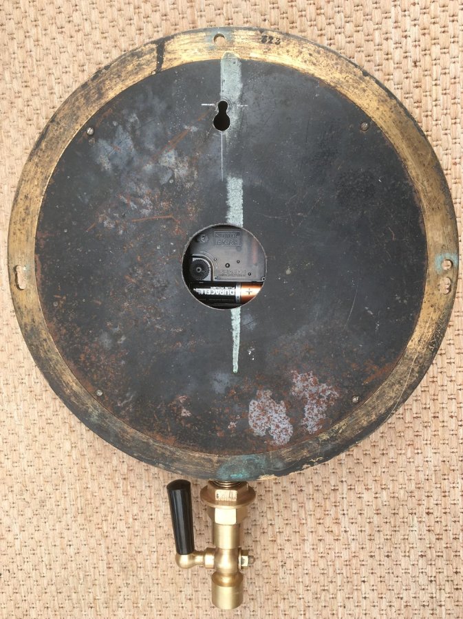

I cut a large hole in the steel backplate to make battery changing easier and a hanging hole

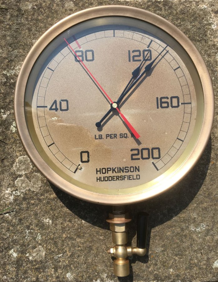

The finished clock certainly makes people look, I chose a mechanism that sweeps the second hand rather then in jumps so it emulates a gauge better. Using the original scale does make for some interesting comments but I think that just adds to the interest. It is about 12" in diameter and very weighty.

I see it's nearly seven minutes past 120psi then?
No pressure to get it finished then
(Boom, boom! I'm 'ere all week)
What a smart piece of work
