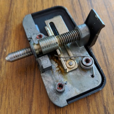

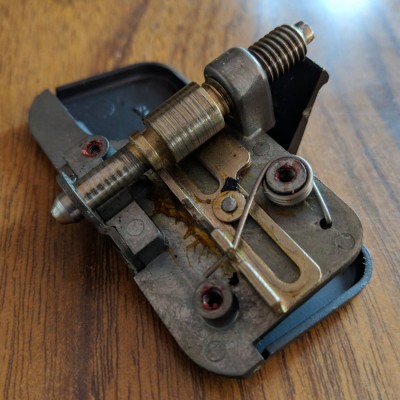

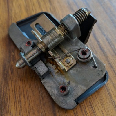

The arming mechanism on the wheel is nicely engineered and is a good example of Poka-yoke.
You can't access the 3rd bolt unless the pin is out far enough.
You can't close the flap completely unless the pin is in far enough.
The pin cannot be screwed in while the bolt cover is open.
1. Pin screwed in fully, device armed, bolt cover locked closed, flap fully closed: 2. Pin mostly unscrewed, device disarmed, bolt cover unlocked, flap forced open: 3. Pin fully unscrewed, device disarmed, bolt cover locked open, flap forced open:
