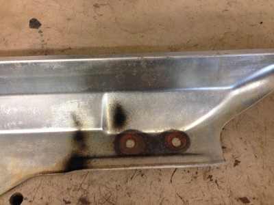

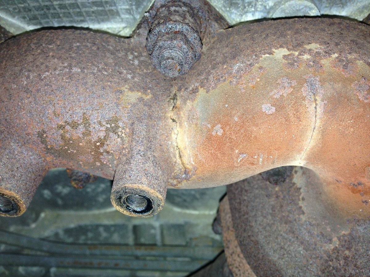

The rear manifold on my 1996 Celebration has 2 cracks in it. I hadn't noticed until I took the heat shield off to take some photos for a magazine piece! They aren't noisy but they are definitely leaking as I can see soot on the inside of the heat shield.
2 distinct cracks in the rear manifold
Tell-tale soot marks on the back of the heat shield
So my options are
a. Live with it
b. Find a second hand one
c. Get it repaired
Any suggestions? I think they are the same for any AJ16 engine but does anyone know if one from an AJ6 will fit?

As I recall, the stud pattern is different on an AJ6 manifold. I remember writing in the magazine many years ago that I suspected that 50%h+ of the cars were running with unknown cracks in the manifolds. the only indication being a very slight chuffing sound on immediate startup that settles very quickly indeed as the early heat buildup in the manifold closes the cracks. That's why you don't even see much sooting behind the heatshield.
I'd like to see a welded repair but I understand it's really difficult to do and not just move the problem to elsewhere in the manifold.
If you're buying a used one, don't overpay as eventually that will crack also anyway even if it hasn't got a crack now.
Also be very careful to support the downpipe when you undo it from the manifolds. As you know the really weak spot in the AJ16 system is the welded 2-1 collector at the end of the downpipe. Leaving the pipe disconnected and unsupported puts an additional load on this very split-prone weld point.
