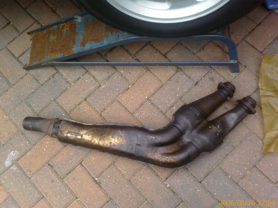

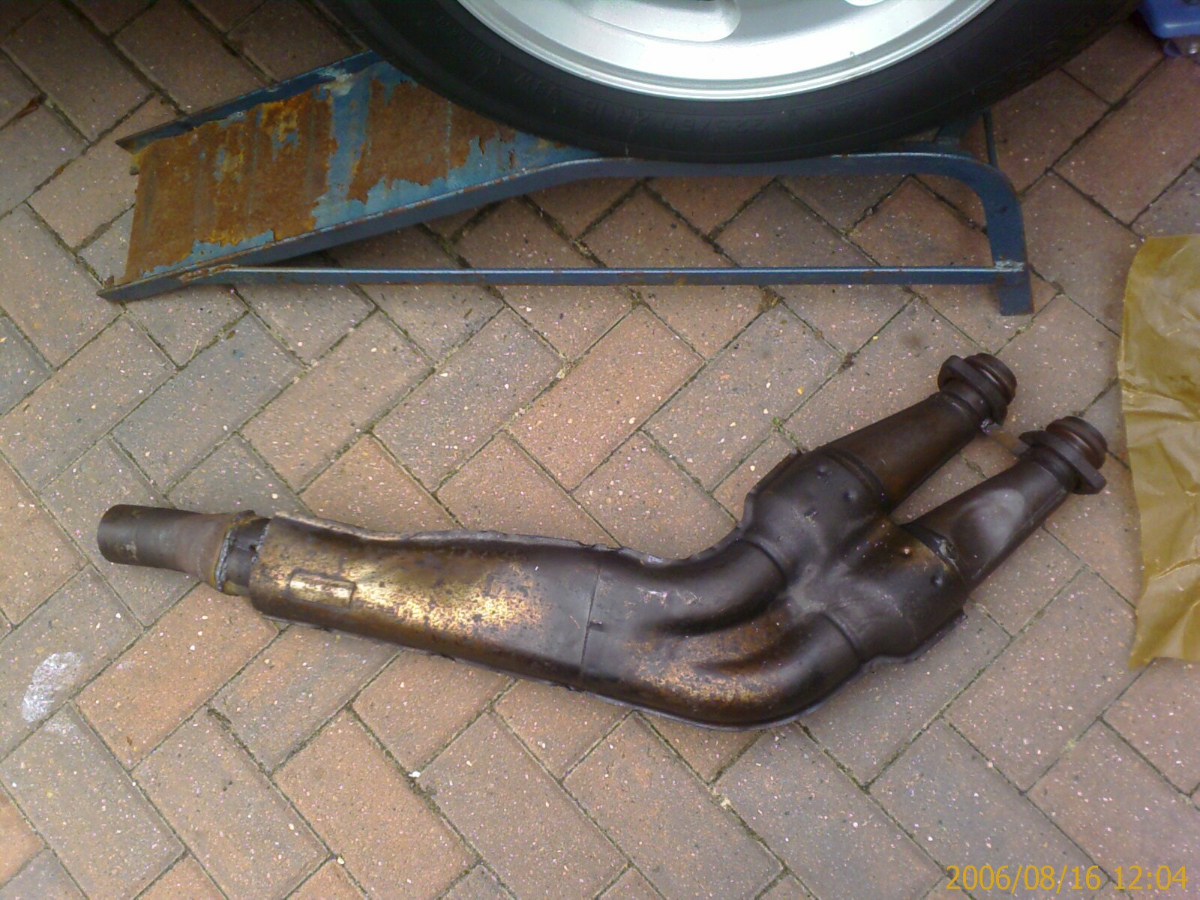

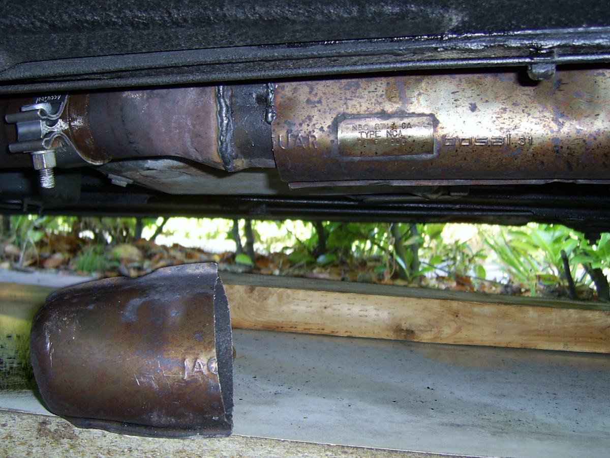

If the pipe has fractured its weld at the usual place (ie where the two downpipes are crimped and then a small "collector" pipe is welded to them which then creates a single pipe that goes to a slip joint) then I'd strongly suggest that you remove the pipe and just get it re-welded at that point. That "Crimp & Join" is not a great piece of engineering.
I had the same problem on my car back in 2006 and I published the issue with photos in the magazine at the time. New pipes then were £1000 and are now unavailable anyway! The cats last a very long time also so repair is quite a realistic option. I paid a garage £30 to rerun the seam around that joint. All you need to do is gently cut off the last 3" of the heatshield and then you can access the weld point. You can see from the second pic below exactly where to cut the heatshield on the "G" of JAGUAR. You can then just tack the remaining heatshield to the pipe or frankly, just leave it as it is. Try and get the car up a bit in the air. I managed to wiggle the pipe out with the car just on car ramps but it's a bit of a pain.
Whilst the pipe is out, it's a good time to change the downpipe studs, clean up the slip sleeve attachment at the downstream end and also change the lambdas if they are more than 5 years old. Disconnect the lambdas at the wiring plugs anyway in order to remove the pipe, then take the lambdas out when the pipe is out and they are much more accessible.
Good luck

Thanks, Paul - you are spot on and your very comprehensive guide will be most helpful.
Looking at the downpipe and heat shield again it is already as your picture No 2 so I suspect a previous owner has already had the welding done - and probably in situ without taking the pipe out. I say this because looking at the top surface of the pipe with a mirror and torch, the weld is incomplete along the line of the fracture (and very rough along the other 75% of the join). I will retain the catalyst, re-weld the joint out of the car and replace the studs and lambdas as suggested.
