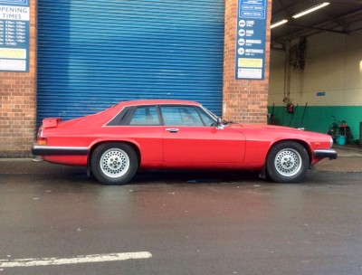

Cannot get the hot air to come into the car. Just purchased, I know the radiator has been recently re-commissioned.
Any ideas?
Thanks in advance.
1985 3.6 manual XJ-S No hot air inside :(

Hi everyone! GOOD NEWS.....
I now have hot air inside the car! Im so relieved as driving huddled up in this weather was becoming tiresome. The solution.....
My water pump was corroded inside. Sourced a new one from Roy at David Manners and hey presto! FIXED.
Still got the cutting out to fix. Mechanic working on that now. Will keep you all informed and more photos to come.
Many thanks!
