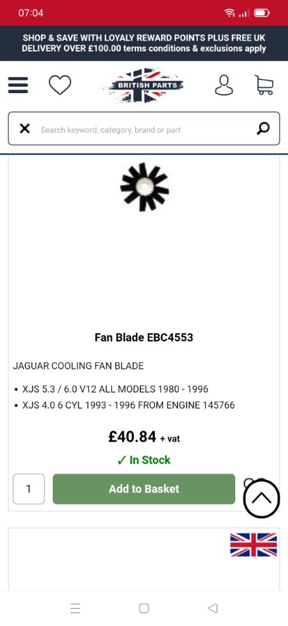

I'm late to the party, but EBC4553 (for V12s) can be had from British Parts for £40.84 + vat and shipping). I purchased one for my '89 XJ-S V12 to replace cracking yellowed fan. The replacement was black and made in Italy: fitted fine and was in action at the recent JEC Castle Combe track day.
