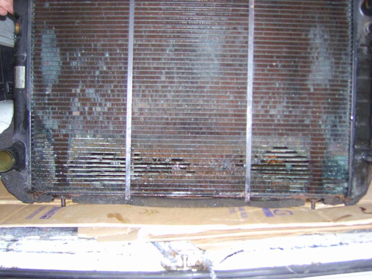

Now, here's the bit you don't want to hear! The weakest part of an AJ16 coolant system is the radiator which deteriorates over time. Debris gets blown through the rad destroying the vanes and significantly reducing the cooling capacity, particularly at idle. And because there are rubber flaps on the rad outside the fan shroud, you can't easily see the deterioration. So, lift the rubber flaps on the right-hand side or look through the fan shroud on the left-hand lower side, and check the state of the rad. This would be a great time to change it, if less than perfect. See my pic when I changed my rad.
Cheers Nick

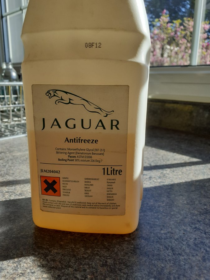

Hi Paul - I'm even more confused than I thought I was. This is what I have been using in all three XJSs I 've had over the last 24 years or so and my current for something like 14. I had my first experience using this variant back in 1997 and have continued. I'm going to regret saying this I know but in all that time I've not had a hose or water pump fail (sods law). Whilst my current AJ16 has yet to pass 100K my previous 1992 Facelift had almost 200K before being acquired by and exported to France.
As I think I mentioned earlier, the "header tank" clearly states "Do Not Drain", whilst the "Service manual says that it is a maintenance item. That said very interested by your comments and observations and will investigate further.

Hi Nick,
Yes, that's confused me. However, I think I might have the answer!
Late XJSs originally used D985 coolant which was blue / green.
Jaguar then moved to D542 coolant in 1997 which is yellow and the one in your photo.
Jaguar then moved to long life coolant in 2000, which is red.
That seems to indicate that at some point, your coolant MUST have been changed from the original blue /green Jaguar D985 to the yellow Jaguar D542 fluid.
D985 is definitely an IAT coolant.
Jaguar "converted" early XK8 cars to D542 as per a Service Bulletin. Part of that bulletin states:
HISTORIC BACKGROUND:
D985 coolant was used in production on the following vehicles:
(i) XJS vehicles until 1996 Model Year
(ii) XJ6 and XJ12 Sedan models prior to VIN 803241 (February 1997)
(iii) XK8 models up to VIN 010341
Note: The majority of XK8 vehicles in the VIN range 001036 - 010341 will have been converted
to D542 coolant under Service Action S813. These converted vehicles should be recognized
by yellow coolant and a corresponding label affixed to the cooling system header tank. Full
details are in Bulletin 303-09 dated 6/97, and Service Action S813.
D985 coolant is blue/green in color. Jaguar part numbers JLM 11979/1 - JLM 11979/5 apply.
D542 coolant was used in production on the following vehicles:
(i) XJ6, XJ12 from VIN 803242 (1997 Model Year) to VIN 812255
(ii) XK8 from VIN 010342 (1997 Model Year) to July 1999
(iii) V8 XJ Series Saloons from VIN 812256 to July 1999
D542 coolant is yellow in color. Jaguar part numbers JLM 20404/1 - JLM 20404/5 apply.
EXTENDED LIFE COOLANT applies to the following vehicles:
(i) S-TYPE from 1999.25 Model Year Introductory VIN: L00600 (and from L25201 2000 MY)
(ii) XK8 from August 1999 Introductory VIN: 042635 (and from A00083 2000 MY)
(iii) V8 XJ Series from August 1999 Introductory VIN: 878274 (and from F00103 2000 MY)
Extended Life Coolant is orange in color.
So, I'm GUESSING that D542 is also an IAT, but it just MIGHT be an OAT! On an US website, I found this analysis by someone:
Here's the disclosed chemistry of Jaguar D542 / DOW 542:
Ethane-1, 2-diol (another name for Ethylene glycol) (CAS 107-21-1) 90% - 100%
Sodium hydroxide (CAS 1310-73-2) 0.5% - <1.0%
Disodium tetraborate pentahydrate (CAS 11130-12-4) 0.3% - <1.0%
Sodium hydroxide (NaOH) is commonly known as Lye, widely used in soaps, drain cleaners, anti-freeze and many other products.
Disodium tetraborate pentahydrate (BH13NaO8) is commonly known as Boric Acid or Borax pentahydrate, widely used in detergents, paints, anti-freeze, and many other products.
Note that neither of the above contains carbon, so they are considered inorganic compounds.
We can not tell definitively if D542 is an IAT, OAT or HOAT coolant because we do not know if all of its ingredients are disclosed on the MSDS.
Interestingly D542 was originally used in the 1997 X300 cars including the ones fitted with AJ16 engines. So that might imply that it should be safe in an AJ16 XJS, as I don't believe there were any material changes in AJ16 engine gasket composition or water hose composition in 1997.
So, as I said, I THINK D542 is an IAT!
Whether you refill with the yellow Jaguar liquid, or a more readily available Blue/Green Ethylene glycol IAT, I would still flush the system through a number of times with a warm engine, not least just to remove as much sediment from the engine and rad before refill.
Hope that helps a bit and doesn't make it more confusing.
