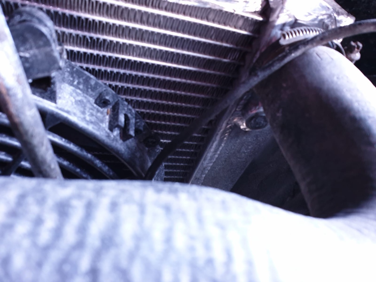

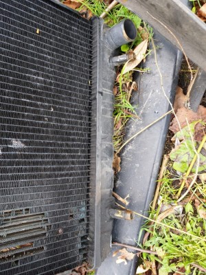

I’ve purchased an aftermarket radiator for my 1990 3.6 auto.
However it doesn’t have the fitting to attach the transmission lines to it.
Does anyone know where I can get these parts? Do they have a specific name?

I have since fixed this by cutting off the old studs on the radiator and brazing a hollowed bolt of the correct thread for the new radiator.
Be aware when buying aftermarket radiators that you may have this issue.

if you connect this up you will kill your car,,,,,
the can on the aftermarket radiator doesn't have the separate compartment inside for the transmission cooler ,
the result will be to kill the engine and the transmission by mixing coolant with ATF

Your existing radiator can be re-cored and pressure tested at reasonable cost and will be like new.
