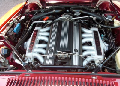

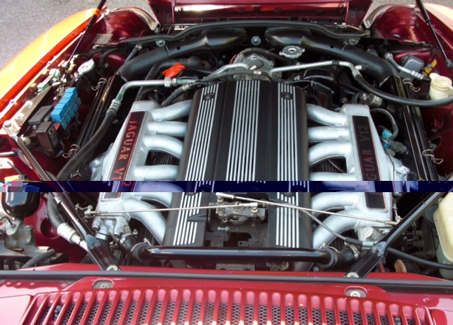

Hello,
I have detailed my XJS 6.0 1995 engine and I am very taken with some stainless steel radiator caps, opposed to the Jaguar plated ones that age quickly. These S/S ones are advertised on the internet at the moment, but they only go up to a 15Lb. cap.
However, my expansion cap for the 6L,(think it doe's not matter so much for the filler neck, as it is just a 'bung'??)is rated at 16Lb.
My question is;
Can I get away with fitting this 15Lb. cap on the expansion res?
What would be and has anyone had any negative result fitting a lesser Lb. cap with these late engines?
Obviously, if Jaguar did not think there would be a problem with the 15Lb cap, they would not of changed it to a 16Lb.one. I do believe this later engine might run hotter??
I would be grateful for your views.
All the best
Nick

Crikey! I could eat my sandwich off that! Some superb detailing there! Wish my engine bay was as clean!

Regarding your engine, very impressive condition
