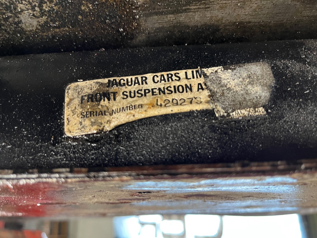

I have been looking at the SNG Barratt’s parts catalogue and noticed that the required part for the components of the Independent Front Suspension depend on what looks like a serial number:
However, the only number that I have seen on the independent front suspension on my car is as follows:
Clearly these two series of serial numbers do not tie up. Does anyone know where I can find a serial number that ties up to the series shown in the SNG Barratt parts catalogue - and even ow those relate to the serial number shown on the sticker on my car? I guess there is a similar story for the independent rear suspension?

Peter,
As Pop has referenced, irrespective of where you ultimately buy your parts, ALWAYS start with the Jaguar parts website. Despite one or two tiny errors, it is the only site that you can trust which will give you the right part numbers.
Also, there are 3 areas in the Jaguar parts website for XJSs, the early cars, the later HE cars, and then the facelift cars. So you can focus on teh right area for your own car. The reason that the SNG catalogue has confused you is that the 2W series cars are pre-VIN ie 1975 -1979 cars. I'm not sure which part you have photographed but that "Serial Number" isn't a Part number for that item.

IIUC the missing bit of information is that the 2W... numbers in the SNG Barratt listing are the last component of the car's chassis number (what's now the VIN), and not a part number. Jaguar parts are usually described as fitting a range of VINs or chassis numbers; the part numbers are rarely on the parts themselves on older cars, except if someone left the sticky label on!
