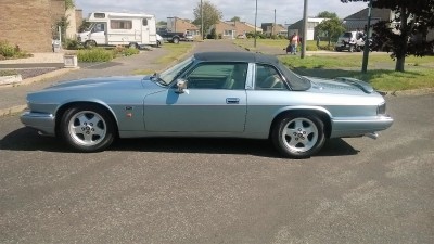

Thanx for the response(s). Apologies for the typo it is indeed 30mm measured from top of tyre to wheelarch. Realize that this is empirical and driven by aesthetics as when the rear end is viewed it looks higher as previously the wheelarch was exactly level with the top of the tyre; now its 30mm higher. Rgds.
Re: 91 Facelift V12 Rear Ride height Adjust
Here's a picture of a car side on and, as you say, the top of the tyre level with the wheelarch looks right
Indeed it does look right. I recall a long while ago encountering the same problem on an associate's XJ12 & he mounted a 4x4 long wooden prop between a beam in the garage & a hydraulic jack in the boot & jacked the back end down & left it for a week. Cant recall whether it worked but it might be worth a try. Rgds.
Charlie,
If that does work, I would strongly suggest that your springs are shot!
Is your front at the right height? Remember, it's very different at the front as the wheelarch lip is higher than at the back.
If the front is right, I think it's either the springs or dampers. Where the springs genuine Jaguar? Aftermarket springs for an XJS are notorious for setting the ride height wrongly. Sadly, there seem to be very few good quality aftermarket springs that give the exact height.
You might JUST be lucky and have the packer shims that were SOMETIMES fitted under the rear springs. I think they were something to do with fine tuning the ride height in the Ford era. If so, you could remove them and lower the height.
