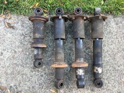

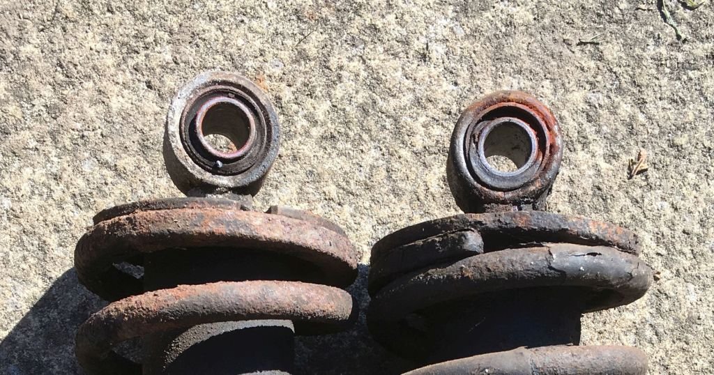

I removed the rear dampers for inspection and I'm glad I did. The top bushes had deteriated badly.
Only one shock could be dismantled, the collets on the others were completely siezed, no amount of plus gas, heat or hammering would release them. Out with the angle grinder with a 1mm cutting disc and they were apart.
As you will see in the photo, one shock is a different pattern to the others and had lost all damping, no springiness left in it at all. Interestingly there was no oil leakage at all, the wetness in the photo was from all the releasing fluid I had used to remove the collets.
Todays task is to clean and paint the springs and to order a new set of dampers.

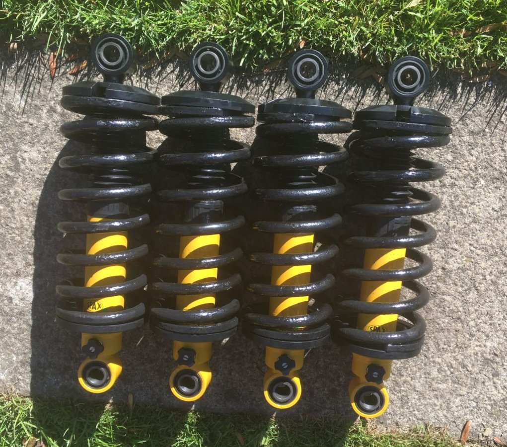

I cleaned the springs up, painted with black smooth Hammerite and attached new dampers. I chose Spax as I have that make on the front already, there are numerous other makes available so others might prefer a different setup. The collet system is far easier to use on the Spax then the originals being a single piece alloy unit. I hope these ones won't be off for a long time but when that day arises the job should be much easier.
It will be a while before I can road test them and adjust the best damping setting as I have now taken the car off the road for a while as there are quite a few other jobs on the list to do between now and spring.
