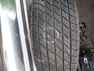

Two weeks ago I noticed one tyre was a couple of psi under, no problem but I have had valves leaking before due to alloy corrosion so I bubbled the area, foam will form after an hour or so showing even a very small leak however in this case all was well.
This week it was again down a couple of psi so I knew something wasn't quite right so off came the wheel for a closer inspection, remove any small imbedded flints etc and the problem became instantly noticeable, a screw perfectly embedded.
With a long journey coming up next week I'm glad to have found the problem now.
