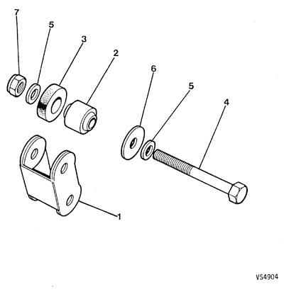

Mitch - do you mean this assembly?

Yes, it is item 1 on the diagram.
I have trial installed the bracket with the 'thicker' walled section uppermost.
Is this correct? I have also deleted the shims as I understand that the poly bushes do not require them?
Thanks in advance,

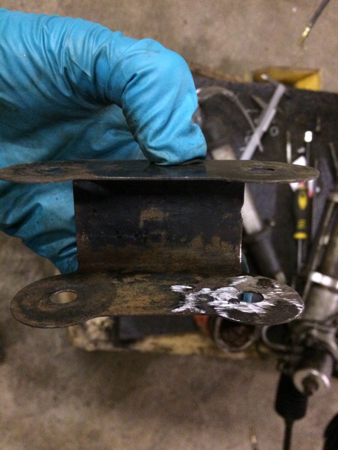

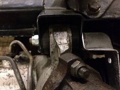

Postby Carnut72 » Sun Jan 07, 2018 2:19 pm
I removed the washer to reduce the bracket thickness as it was too wide with the poly bushes.
As you can see it now fits perfectly!
Washer removed-just some paint to touch up required
Nice fit now
