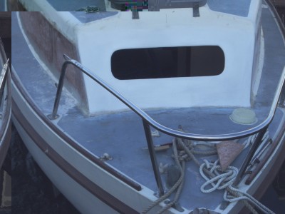

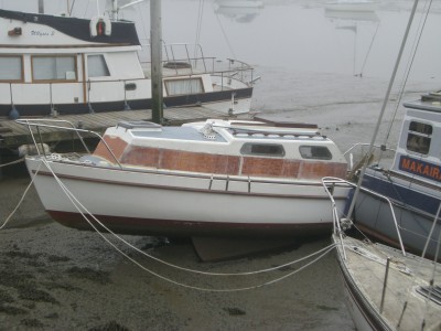

An old scrap fibreglass hull, Phil.
Mast, furler, sails etc, etc all up for grabs to fund the rework as a shed/workshop.
Hull ok, interior rotten as a peach which doesn`t matter, engine water damaged and now removed complete with delaminated engine bed.

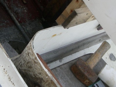

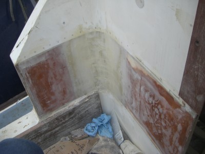

Rebated and epoxy glass sheathed ply panels pre cut and glued into place with epoxy/cotton fibre slurry mix. All pulled together with slave screws which get removed once the goop has cured. Internal joints quarter filleted with cotton fibres using a round ended mixing stick as a shaper. First stage as here.
Now the front end is stable, the back end needs similar treatment. Note the radiused molded shape which will be tackled using three epoxy laminated layers of bendy 4mm ply. This ply has all the grain going in the same direction with a flexible interlayer which holds it all together as the ply is bent around a radius. Dead handy stuff. Tody`s job plus I hope a couple of panels fitted. Messy old game.
Detail of the radius to be attempted.

You only got that one tool in your box
or is it the only one in the photo!

A lump hammer is the best reaction block in the World, John. Hit it better!

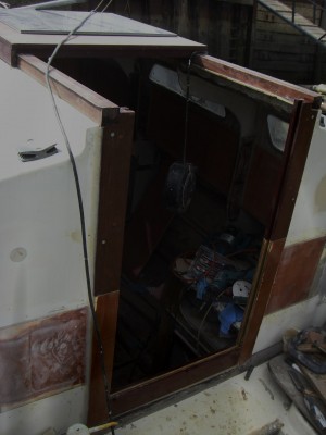

The result of the days labour today then.

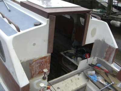

Glass fibre thinned to 4mm where required, Bonding surfaces cleaned of crud, then three layers of bendy ply epoxied and screwed together as a laminate whilst the goop cured. Quite a job. Screws then removed. Inner and outer side panels gooped into place and screwed top and bottom to existing structure. 3mm gaps back filled. Internal panel edges filleted. Minor fairing carried out to external face of bendy ply.
Then then after speaking to `Orrible Rob on the phone, I trod on my reading specs which are now a write off...............
The same process now has to be applied to the other side of the boat. Another repeat session coming up.

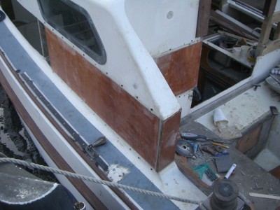

A few more pics here then. Note first doubled up and extended deck to cabin roof extension upright in 068 and coffin cuts in ply forward left to allow ply to be bent around the curve of the boat. Quite a struggle with that panel and have to do the same again on the other side of the boat. Loads of clamps, screws and timber bulks needed to persuade the ply panel into position. The panels are externally epoxy glassed so the outer skin is in tension, the centre in shear and the inner skin in compression. Hence the need for the coffin cuts. Those get back filled with epoxy and cotton fibre slurry to restore structural integrity. So far, so good. Stinky, smelly, dusty job.

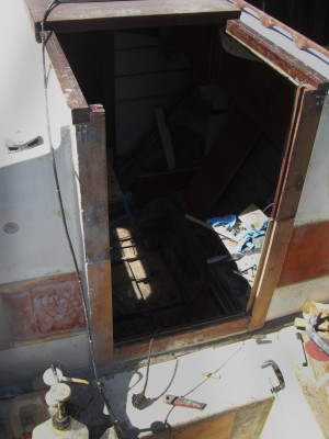

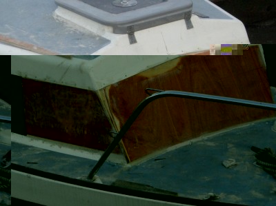

How right you could be now all the structural paneling has been fitted, a window cut in, cockpit washboard runners extended and final filling and fairing done to the aft cabin vertical sections.
A few more pics then beginning with the window and panel section at the front end of the cabin. All faired in, epoxy glass cloth applied together with a filler mix. Once cured, the fairing mix was flatted smooth, window cut in, edges routed and epoxy applied to exposed plywood end grain. Once cured, rough flatted, primed and finally the window screwed into place on a bed of polysulphide sealer.
To the aft end of the cabin, the washboard runners needed extending to cope with the additional height built into the cabin. I had also dropped the lower edge of the runners to make access to the cabin easier. Hence the extra sections needed. One new washboard will need to be cut and routed as the cabin roof has been raised exactly 11.5 inches to gain headroom. Careful building ensured that the cabin width retained its original dimensions.
So that is the work done over the last couple of days.

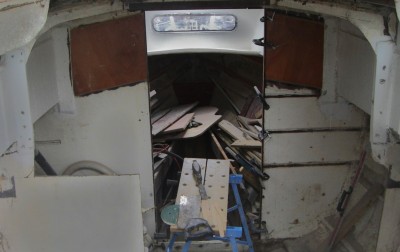

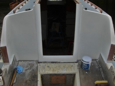

The next batch of work complete and primed up. Just the sides to fill and fair now. Then the gloss paint can go on.
Also partially completed bulkhead extension infills and widening of opening to allow washing machine installation at future date. A work bench with bar type flip up centre portion top will allow access to the front cabin. A bath was also to be installed but a cunning plan now hatched to make use of the cockpit area by flooding as the bath tub itself! Hot water to be heated by a 3kw in line heater pumped into the cockpit to fill to the brim. Shaln`t know myself!! I`ll be doing that job once I`ve constructed a shed over that area. Complaints will be flying around otherwise!
