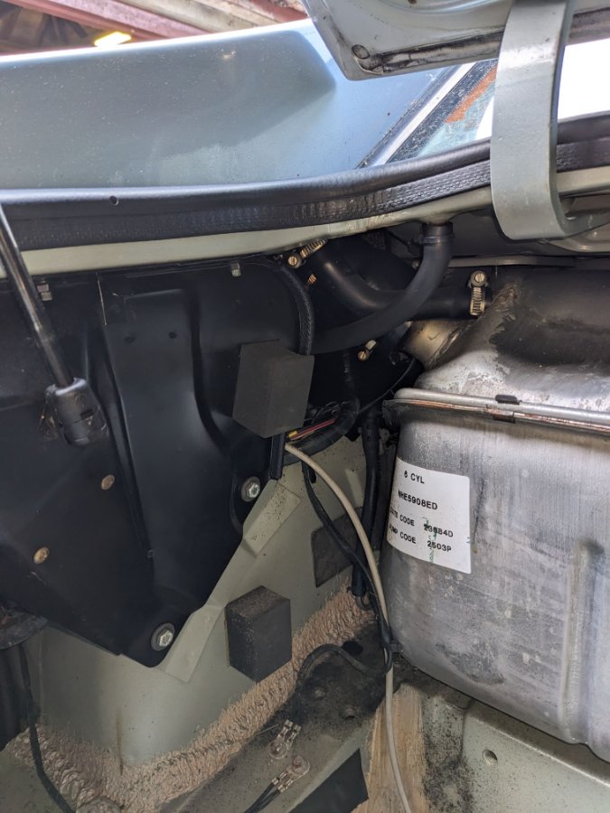

- LHS hockey stick. On my car there were several unused connectors on the loom/harness behind the hockey stick and photographing these now will help on reassembly
- The RHS hockey stick if not already removed.
14) You should now have a fairly clear view and access to the fuel filler assembly.

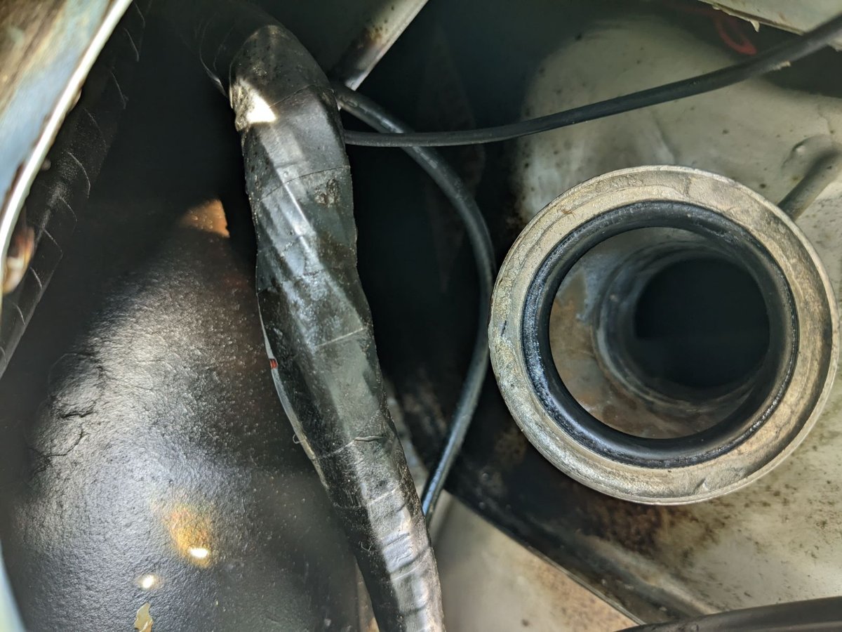

I started by getting the rubber connector loose using a combination of twisting it and then tapping it longitudinally to break the seal between it and the metal necks. When free it will slide longitudinally but you can’t remove it.
Getting the filler neck to move is difficult because there are no purchase points so I re-fitted the filler cap and used that to try and gently rotate the neck clockwise. I also applied some gentle, targeted, tapping on the right-angled breather connector on the inside to try and rotate it counter-clockwise. I used a large diameter drift and was quite delicate because I didn’t want to break anything but it did work. Once it is free you can rotate the filler neck anti-clockwise and withdraw it from the car along with the rubber connector and the tube clips.

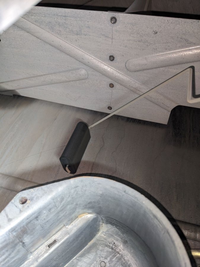

22) I was fortunate in that I could see that the inside of the tank was in excellent condition so I didn’t need to remove the tank completely.
If the tank is not in good condition then now is the time to take it out to clean and repair or replace as required as you probably don't want to do this again in a hurry. With the tank slid back towards the boot space I could easily access the fuel pump with the tank still resting on the shelf. At this point I removed several more litres of fuel that were sloshing round in the back of the tank
