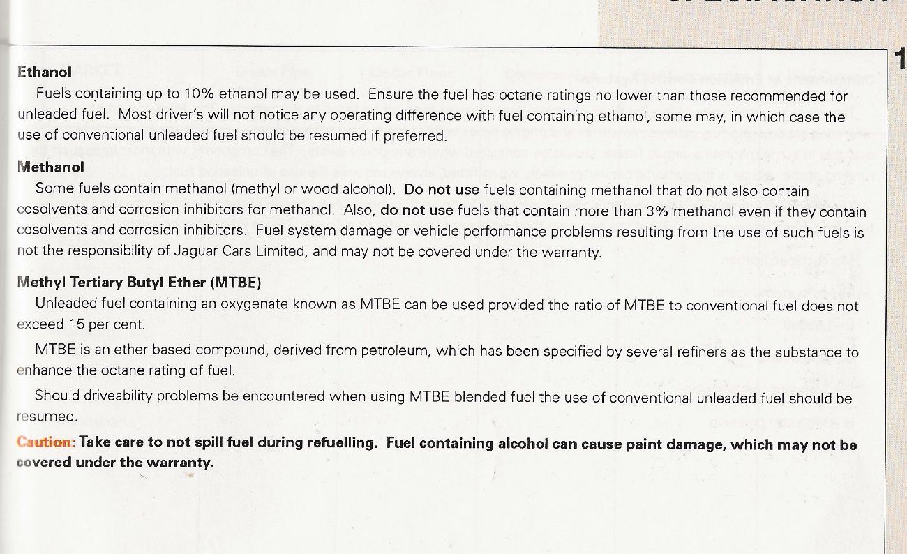

Came across this when flipping through an older XJS Handbook (JJM 10 02 06/20) clearly states that E10 fuel is okay for engines 4.0 or 5.3 running cats. Most interesting.

Re: The new E10 fuel
Nick,
I can't read that attachment clearly but I THINK it only mentions octane rating not ethanol composition.
Having said that, my owners handbook for my 1994 car does state that ethanol of up to 10% is acceptable for the engine. My much bigger concern is the 26-year old fuel hoses etc and how ethanol might affect those.
So, I too will not be using E10 fuel in the XJS. I'll continue to use 98 or 99 RoN with a max of E5.
Apologies. Page 271 of the "Handbook" describes the use of ethanol at 10%. Hope this image is more visable.
Nick
Nick

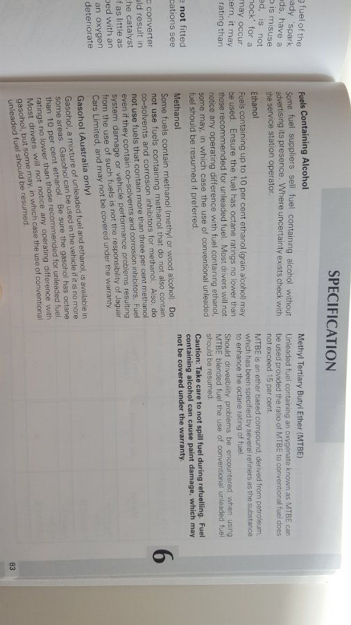

Hi all,
E10 seems to be ok for the 6.0 V12. Please see the text below from the handbook (JJM 10 16 06/40) - 1994.
AF
AF
1994 6.0 V12 Coupe - now gone
