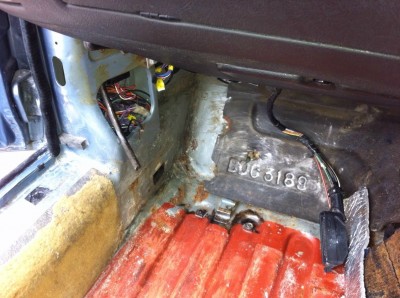

Good news is that, despite heavy rain yesterday and overnight, there is no water in the car today at all - dry as a bone!!
Picture below shows the footwell with the drain tube sticking out. I've now put it back inside the A pillar and made sure that its poked well inside the sill and draining properly.
As you can see, I now have some talc to clean up and some rust prevention to do!
