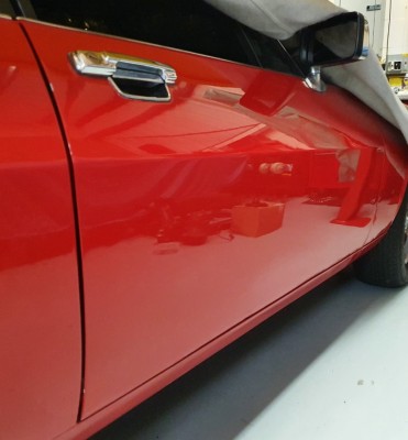

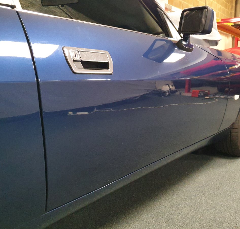

Re: XJ-S doors - are facelift and HE same/similar?
Roger,
At the weekend, I tried to compare the doors on my pre-HE and facelift cars. I looked at them visually and also measured them in certain dimensions. As an example the measurements of both doors were taken:
- from bottom of door to the waist crease line at the forward edge
- from bottom of door to the waist crease line at the rearward edge
- the length of the waist crease line
Recognising paint differences and manufacturing tolerance, the doors were identical between cars, in all 3 measurements to within 1mm,
I couldn't measure the exact profile but looking at them visually, I think the lower half of the doorskin is identical to both cars. Certainly, if I was effecting a repair, I would consider using a skin from either era and work on the assumption that I could get it to fit.
Hope that helps
Good Luck
Hope that helps
Good Luck
It looks to me like the door handles are in completely different places - much lower on the facelift which is clear in Paul's comparison pictures
