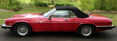

'89MY XJR-S V12 (Wikepedia pix, I'm not an XJS expert but think only Celebration was without ¼ lights?

XJS Convertibles don't have quarterlights
Re: Cant get into car
Posted: Tue May 07, 2019 6:51 pm
by RichardSEL
Having posted the wrong pic I've obviously forgotten why I was crossing the road :roll:
Not having had (but nearly buying one but when I sat in it it was like sitting in a bucket -- for me anyway) an XJ-S I seemed to remember that "¼ light" operated independantly of the main window. Or at least was a seperate piece of glass...
'89MY XJS Convertible 2-Door 5p3L V12
