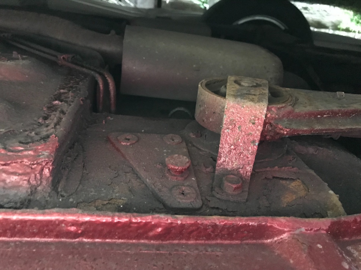

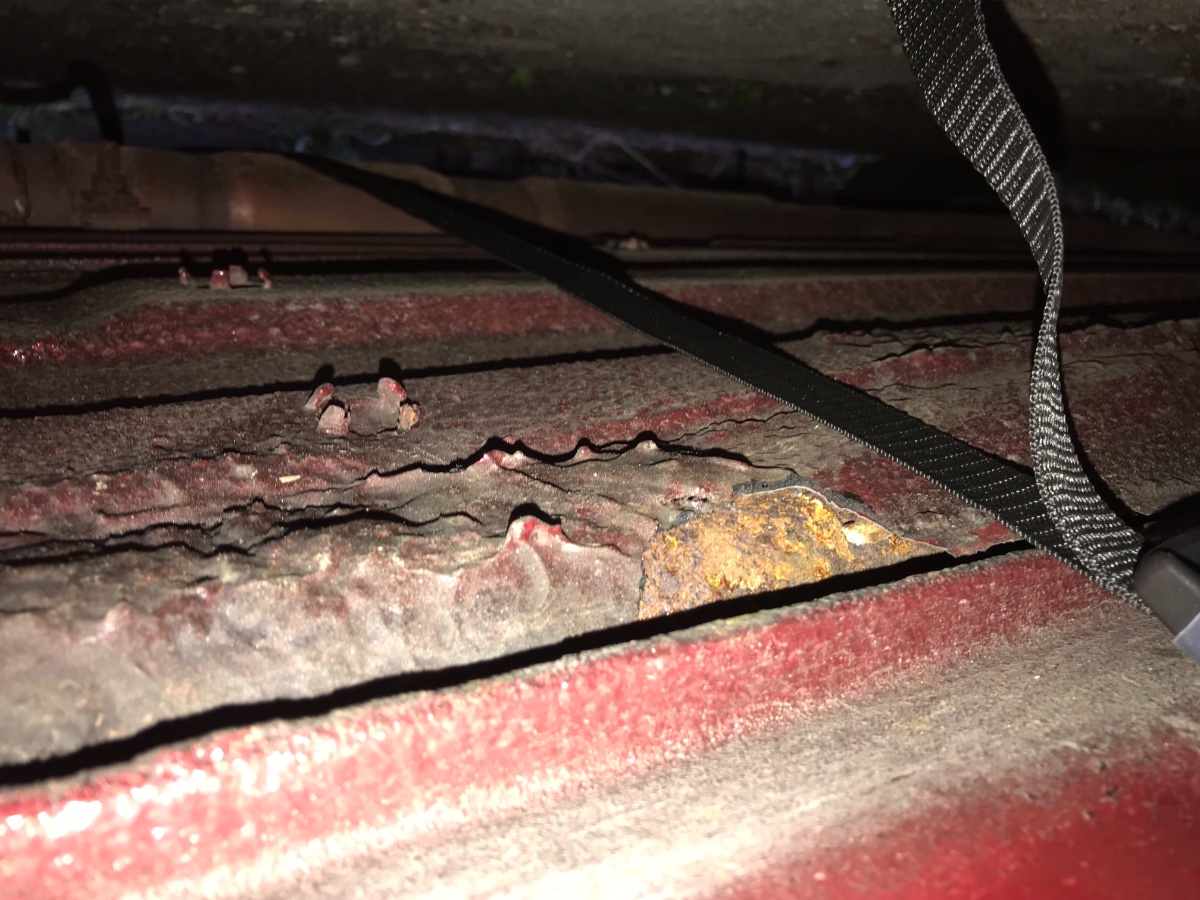

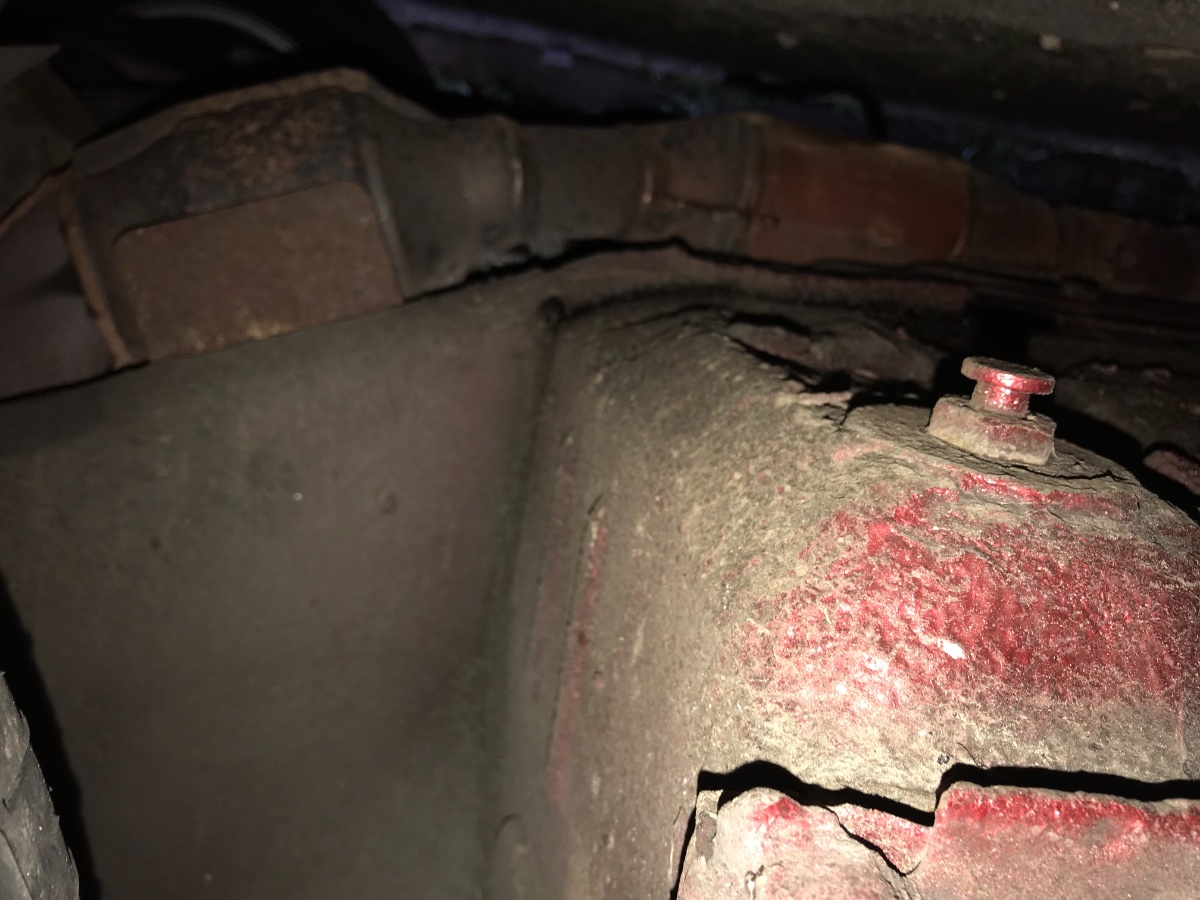

Hi Guys,
I recently bought a 6.0 1993 xjs and absolutely love it. However, I was securing a cover this afternoon and noticed a few patches of rust around the jacking points, I’d appreciuany views on how serious these are and the best ways to remedy it if needs be?
Thanks in advance, Ben

Good you spotted it - hopefully is just surface rust where moisture has gotten under the hardened and peeling underseal. From the overspray looks like some other recent remedial work has been done in the vicinity already?
I would get under there with a screwdriver and chip away all the lose underseal - hopefully you will not find any holes. If you do then as structural you will need to get professional advice on what needs to be done. Hopefully, all being well you have no holes so can wire brush or sand off the loose rust, treat with rust killer, repaint and re-underseal.

Thanks for the comment, I've booked it into Arun Independent Jaguars in Pulborough so they can have a look at the underbody on a ramp. I'm having to pay for the ramp time but think it'll be worth it for piece of mind etc.

It's an unfortunate reality that cars of this age can and do rust in very difficult to get to places. You need to be looking in other areas too, such as the windscreen scuttles and tops.
The messy overspray suggests the sills were tarted up before selling, hopefully it isn't too bad. Sorry to be blunt.
