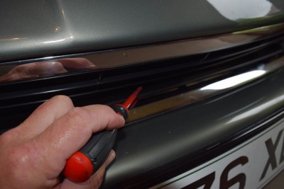

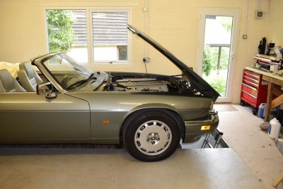

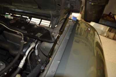

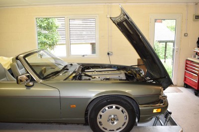

I have now done the work and the result is amazing - the bonnet rises and holds open smoothly under strut power and there is much improved clearance, especially at the radiator end. I did the work as follows.
1 Raise bonnet and prop open with temporary support. Remove old struts.
2 With the aid of an assistant continue raising bonnet all the while monitoring clearances at the front. Critical clearances are bottom of grille to bumper, and bonnet hinge cover plates to bumper. When the desired/maximum opening has been reached fit a longer temporary prop to hold the bonnet open at the new position.
3 Measure and record the distance between the centres of the strut mounting points.
4 Lower the bonnet to the original open height and re-fit the original gas struts. Tie a small piece of string tightly around the strut piston rods; close and latch the bonnet and then re-open to the original height. The string will have moved to the position of the cylinder when closed. Measure add together and record the string to mounting and cylinder lengths to get the length of the old strut when closed.
5 Measure and record the piston rod and cylinder diameters and the mounting point details.
6 Order new struts same as existing (the force in Newtons will be stamped on the strut body) except with the new closed and open lengths. My maximum closed length was 330mm which limited the maximum new strut open length to 585mm - only 5mm less than my ideal.
I had my struts made and supplied by SGS Engineering - they were absolutely brilliant (Ashley took a lot of time and trouble to check, double check and get it right with me) - cost not much more than off the shelf units and they arrived the next day. A 10 minute job to fit. Cannot understand why I didn't do this a long time ago! Will upload more photos later today. Robbie

Re: Bonnet strutt modification
Further photos attached
great work and seemingly worth the effort
i will say that your original struts seem more limited than mine , ( 1989 coupe )
i will take a side on pic myself and pop it up for comparison , as i feel that i have a similar angle to your now modified struts
the results will be interesting
BB
