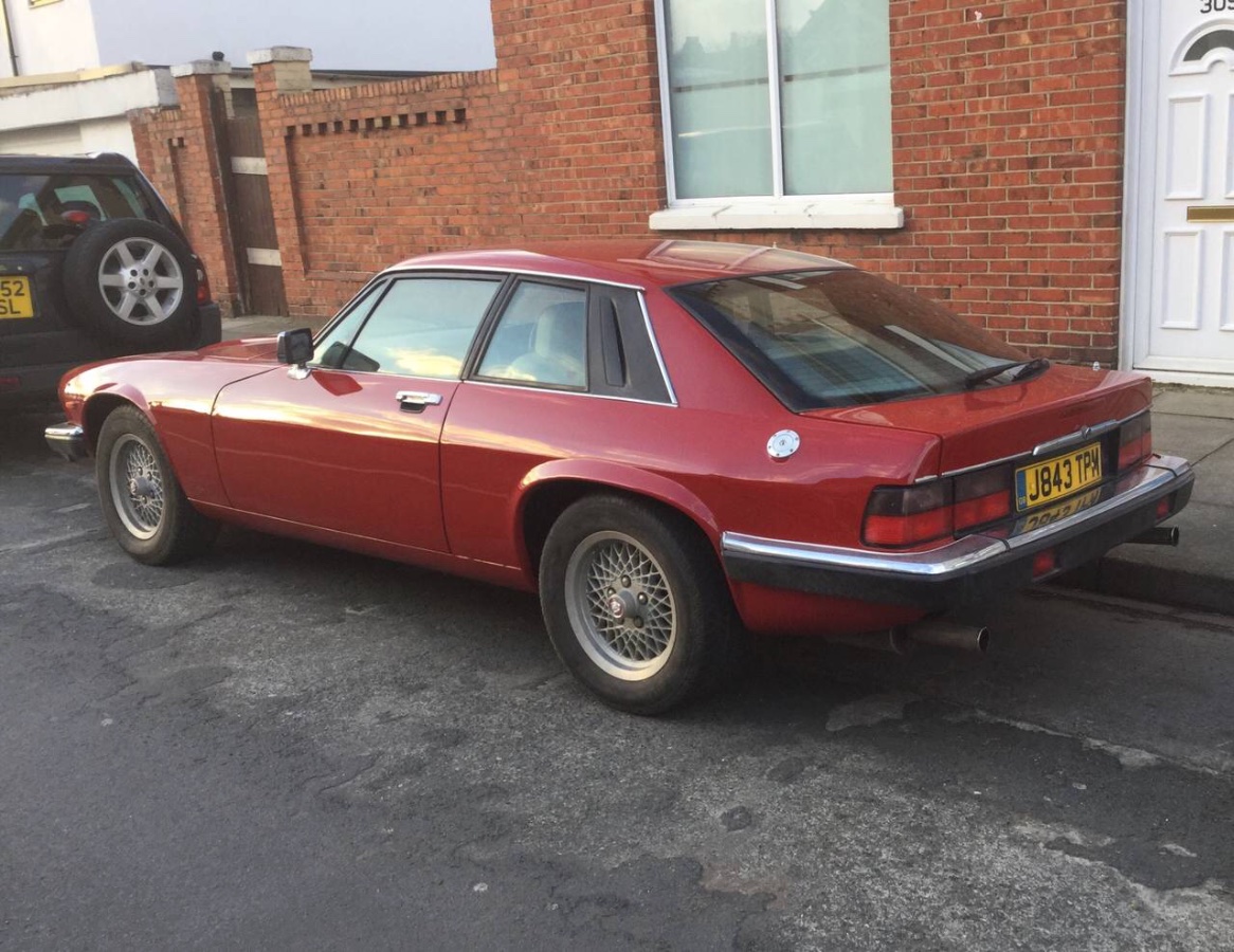

Posted: Mon Feb 05, 2018 8:21 pm
by lilium
She’s back on the road and can be seen driving around Portsmouth I would love to get in contact with the owner who done this conversion. I think his name is Mr Fox?
