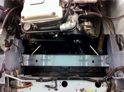

I had a can of the body colour made up and tried a bit but it was obviously wrong and didn't match the under bonnet "finish" at all.
So plan B - I took the radiator cross braces off and took one into Rainbow Paints for matching. The ladies there got out loads of "swatches" and we set about finding a colour match. Well I think we got pretty close! I got a can made up. The mistake I made was to order it in matt. That turned out to be too flat. So I got another can in satin and that's much better.
So judge for yourself below!
Next step will be to blitz the area and inside the cross brace with Waxoil.
The match isn't exact but at least it will mostly be hidden behind the cooling pack when it's back together!

That's matched in, pretty dam good. A posh new radiator to go with it, all coming along a treat.
I just love the facility to enlarge the photo you posted - better "blow in" that spot adjacent to the alternator and replace that stretched grommet near by.
Oldtimer

Yes - there are a few spots to tidy up on the inner wing.
The grommet isn't stretched - it's supposed to be oval!
David

Paul - they made it up to the recipe for the swatch. It's on the can so I can match it again so long as I don't lose the can!
I've ordered up a load of stainless bolts to change anything I can.
If you look carefully at the photo you'll see one of Andy's brackets already fitted! Works very well!!
Bottom hose is going to have to soldier on as you say. Jaguar do list one but at a scary price! Can't see anything wrong with it so will keep it on but have changed the others.
David

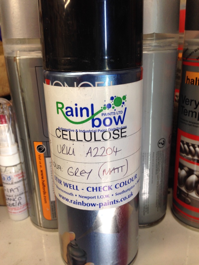

Hi Sonic - I'm away from home at the moment but I'll have a look for you when I get back. Give me a prod if I've forgotten!
Re: Under bonnet paint
Here's the label on the can. This is the matt one but I guess the code is the same?
