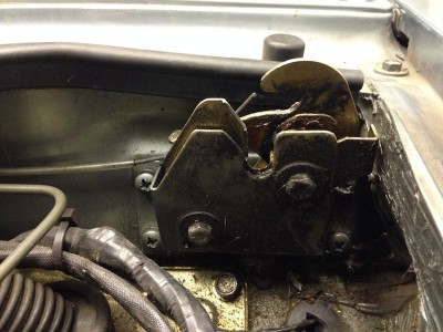

Photos added, one showing, though it is difficult to see, is the bar resting on top of the catch.......should I need to just bend this a bit?

Re: Bonnet struts
from the first pic you can see the peg resting on top of the hook, this should not be like this
first , ensure the hook is fully pulling back when in the unlocked position, it might not be being pulled open enough to allow the peg to get out , which is why you have to push around the bonnet , this can be adjusted by adjusting the cable pull , there could also be debris inside the hook mechanism stopping it open right up ,
if the pegs on the bonnet look the same, then i bet its the hook not working correctly

Re: Bonnet struts
Hi Thanks,from the first pic you can see the peg resting on top of the hook, this should not be like this
BB
I looked to the "peg" s and sure enough they each differ, the one on the offside sits in however so I am guessing I try to adjust the NS one to match.
