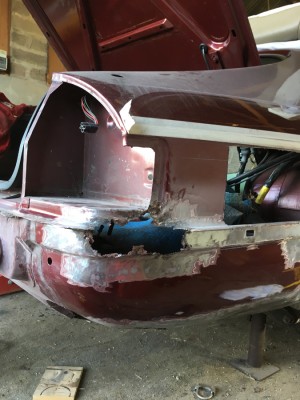

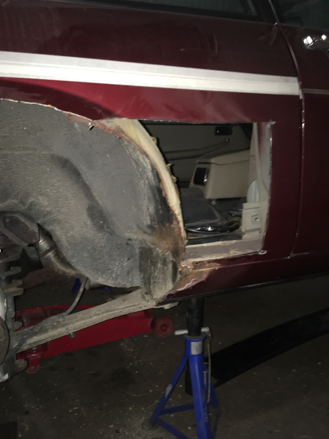

I've just started to strip down my XJS to repair the rust around the wheel arches. I have new replacement wing panels but have come across more rust around the lower quarters and the corners under the rear lights. I'm hoping someone can help as I can't find a replacement L/H lower quarter and a repair panel for the lower light panel.

The lower rear quarters are an absolute classic - mine are gone too on the driver side. Keep an active search on eBay and contact breakers if their panel is any good.

a bit of lateral thinking will also gain you repair sections, door bottoms will act as front wing repair sections, as the profile is the same, just as it is for in front of the back wheels, doors are cheap to buy and cut up for repair panels
