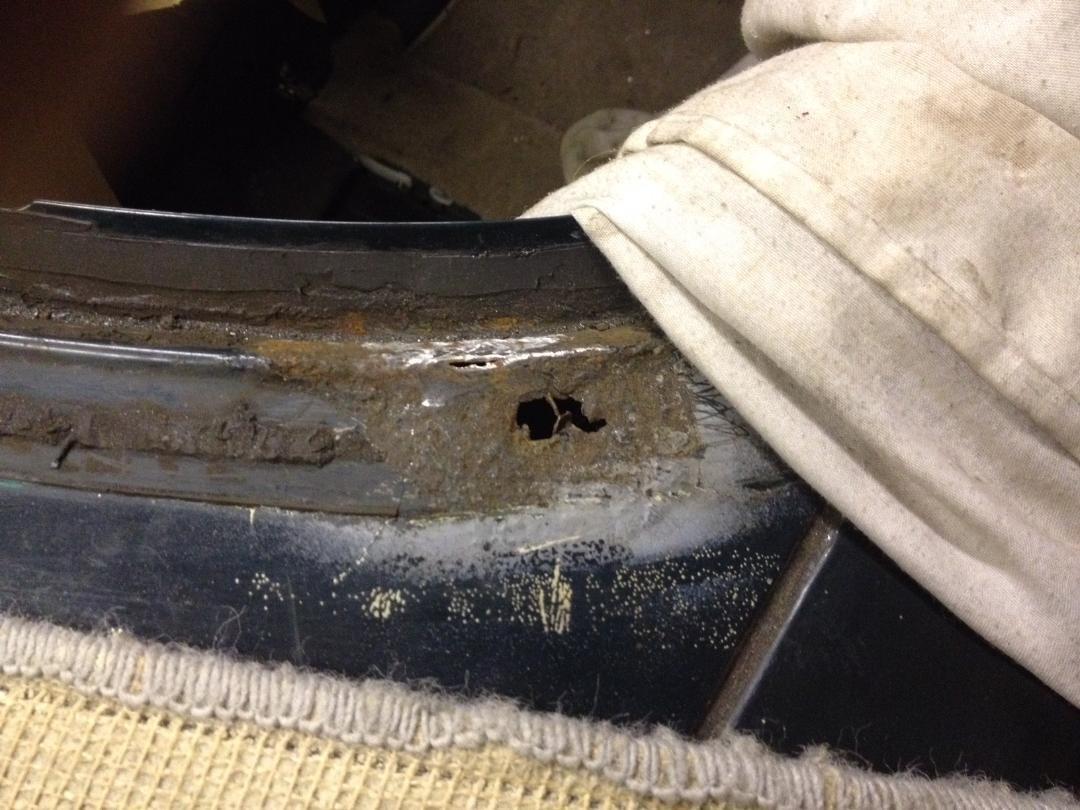

As the picture shows, you can get sufficient to cause nightmares just removing the chrome.
I did that to mine many years ago, and soldered a piece of tin can over the hole and covered it in underseal before hiding it again. Much more recently, a couple of years ago, I needed some work on the rusting trim retainer brackets at the top, and got the body shop to repair the hole properly. No idea how well my bodge had lasted, but nothing fell off or flooded in the intervening decade or two.

I trust that you were able to get the rust damage successfully resolved. As you will have realised from my July 2012 article and photos, the damage that you see in greeban's photo is this thread, his damage was absolutely minimal compared to what one might find! (David R, if you think that photo is a nightmare, wait until you see the ones where the rust has crept unseen into the plenum chamber and half of the inner wing!)
As I alluded to in my article, if you can see a bubble on the scuttle, you have a big problem, but even if you can't see a bubble, you still might have a problem! And despite what some people say, convertibles definitely aren't immune from the problem, as I well know!
