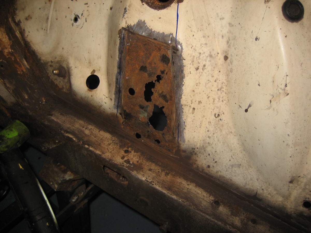

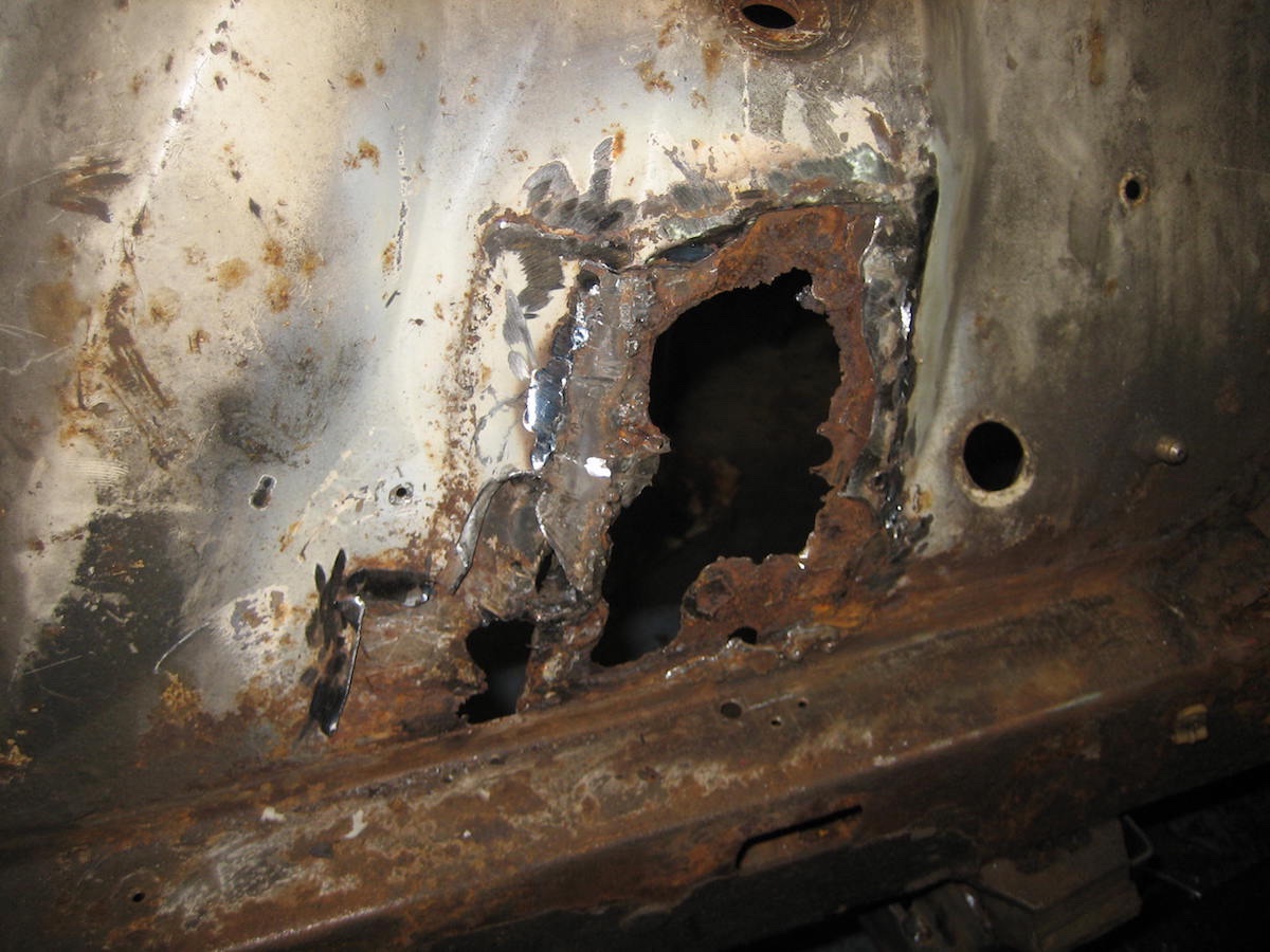

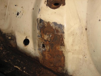

Once stripped, I counted up about a dozen areas needing welding, ranging from major things such as the floors, to much smaller repairs. I thought I'd start at the front, so tackled the corrosion between the shock absorber mounting strengthener piece and the inner wing. This didn't look too bad on the passenger side:
However, a bit of cutting revealed this:

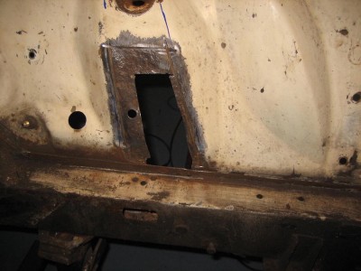

I tidied that up by cutting out the worst area:

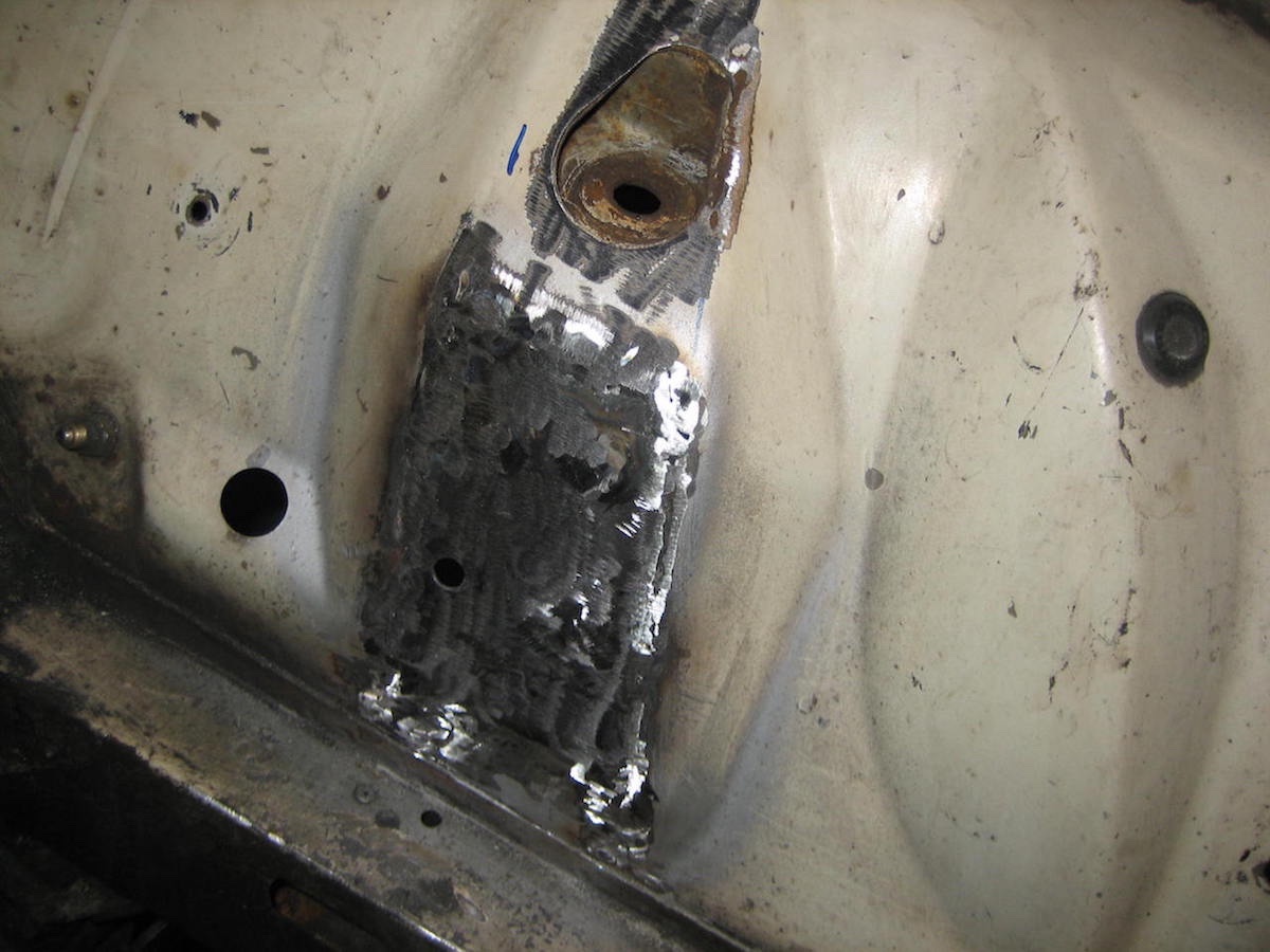

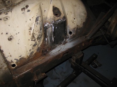

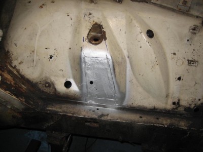

and then welded in thick gauge steel to repair the strengthener:
and then finished it off with standard gauge steel
It needs a bit of tidying up still, but now its rot free.

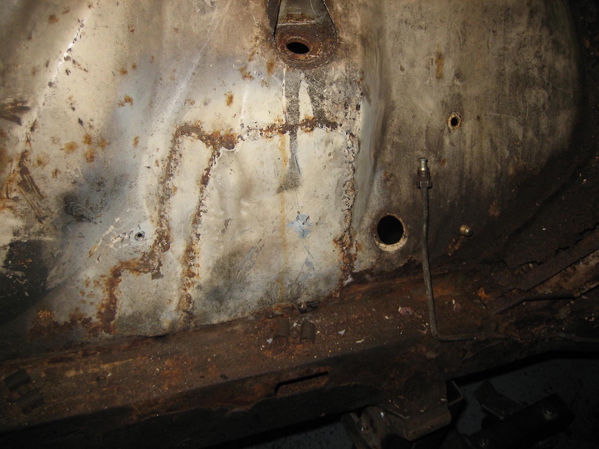

On the driver's sides repair had already been made. I thought about grinding off the weld and making it look better, but then I thought again and removed the repair piece:
That revealed this:

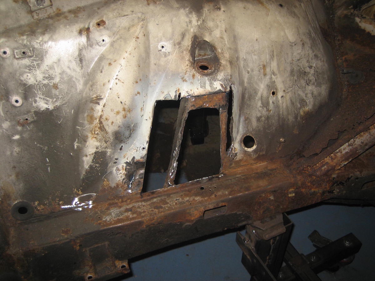

and with the worst cut out:
Roger S

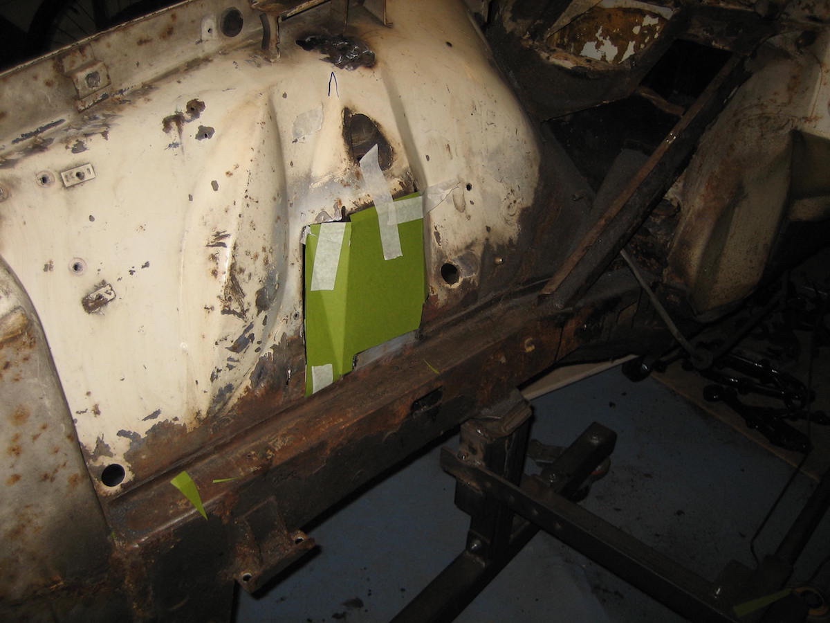

First I thought cardboard:
Then I thought metal:

I think the metal may last longer......
Fabricating the metal was actually really quite tricky due to the numerous folds and bends in the piece. I ended making it out of two pieces and welding up one of the fold lines.
