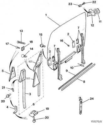

By "top of the door" do you mean a black triangle about 2 to 3 inches on a side just at the front of the glazed area, i.e. a fillet between the door glass and the door frame? If so, it is the cheater, and all you have to do is unscrew the inner one to expose the screws holding the outer one. There's probably a whole load of sticky sealant as well. Mine is metal, not plastic.

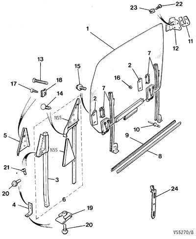

I think it will also be necessary to take the door card off so you can get to the lower fixings that attach near the bottom of the door. See exploded diagram below

Thank you for the info it is the outer part of item 5 on the diagram, I plan to have a go today
