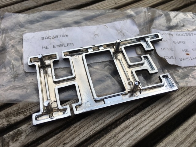

The XJ-S and HE badges on my boot (1983 coupe) are looking a little tired. Also there is rust bubbling under the HE badge so I am wondering what to do. First question, is it easy to pry off these badges without damaging either the badge or the paintwork? I assume they have locating pins on the back of them or maybe not, maybe they just stick on. I'm guessing they have locating pins with corresponding holes drilled in the boot as there is rust starting there. Anyway I'm torn between buying new badges and trying to re-chrome the tired ones with chrome sheeting that you can get from model shops.

You are right in that the badge has pins that go through holes in the metalwork and are held on with push nuts. They also have two sided sticky foam.
They can be removed with care but you've identified the pitfalls correctly. A bit of heat from 'Er Indoors' hair dryer and careful levering with a plastic tool will get them off. Obviously the push nuts have to be removed from inside first.

a quick pic of what you have will help us identify what you have , as there were plastic and metal versions of all badges
the badges do not lend them selves to refurbishment very well, and the chrome backing tape can look a little odd on them ,
removal is by way of gently prying them off , as David says some were also double sided foam trim tape ,
sourcing alternative used or new badges could look much better ,

@ david, I think I had a look inside the boot lid and from memory there doesn't seem to be a way of getting to those pins from the inside. Am a bit confused.

the badges will be pushed into a plastic retainer in the bootlid , simply gently pry off

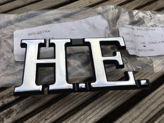

Sorry for late response BB. Thanks v much for reply but I found a NOS one from Growler Parts, fitted it and all good.
