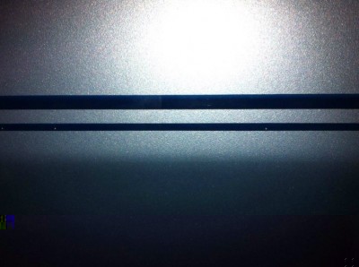

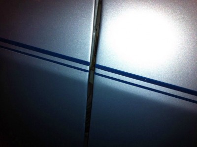

Re: Celebration coachline spec
I offered to measure my coach lines and post some pictures and then promptly forgot! Senior moment I guess!!
The rough measurements are
Top stripe 3.25mm
Gap between 3.25mm
Bottom stripe 2mm
A couple of pictures below
Top stripe 3.25mm
Gap between 3.25mm
Bottom stripe 2mm
