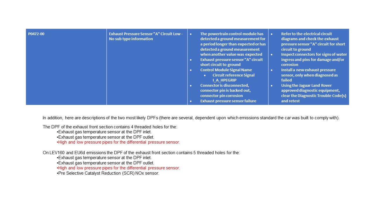

Interesting - you are correct about the diffuculty of diagnosing an 'intermittent' fault, unless it appears while you are watching. However, have a look at the attached file which has come from the Jaguar repair guidance available to dealers. I do agree that finding an intermitted fault is not easy but there is some good information in the guidance.
Good luck

Paul, thanks for that information. The sensor has now been replaced so hopefully it's all over - can't be sure for about another month!
The fault re-occurred a few times in close succession, so whatever failure had been brewing for a couple of months decided to stick around. It became almost permanent so was easier to locate. I chose to get the car recovered to the dealership by my breakdown service as I didn't feel it was great to be driving through rush hour traffic.
