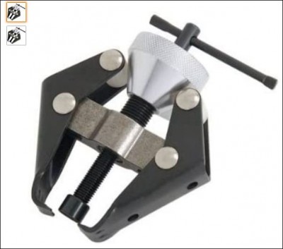

Hi Andy - This is what I normally use to remover the wiper arms. I need to get in there myself shortly as I have, what I expect to be a slight blockage on my near-side washer nozzle.
Good luck.

Blimey! I've never needed more force than a light "waggle" of the arm. It's not a force-fit, nor is Loctite appropriate.Hi Andy - This is what I normally use to remover the wiper arms. ...

Sometimes it needs more than a wiggle if they' have not been off in a decade or two. If so something like I posted applies an even pressure which must be a good thing
