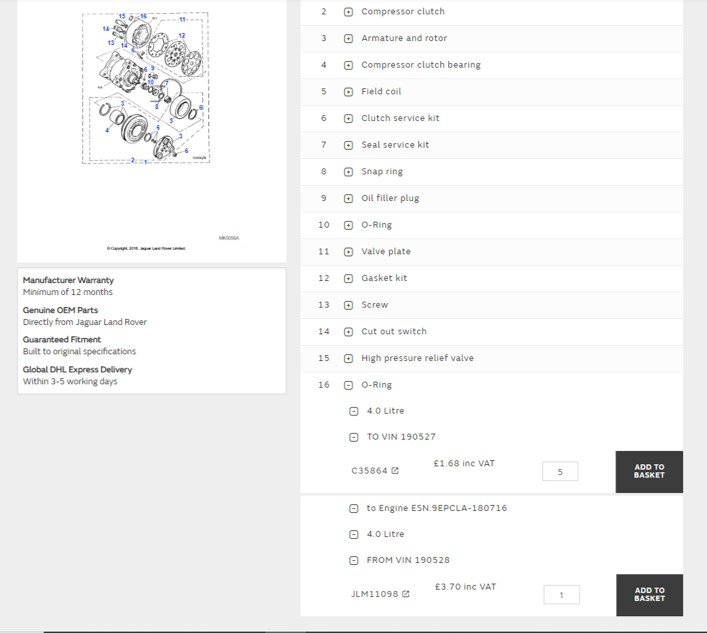

The Jaguar parts system shows that there are two seals on the back of the compressor for early AJ6 cars to engine 9EPCLA-180716. Same part number - C35864. It SEEMS to imply that these seals don't exist on later AJ6 and AJ16 cars? Confusingly, my dealer definitely replaced these on the back of my old compressor with C35864 some years ago (even though I have an AJ16 car) and I have 3 spare seals left from the pack of 5 that was purchased.

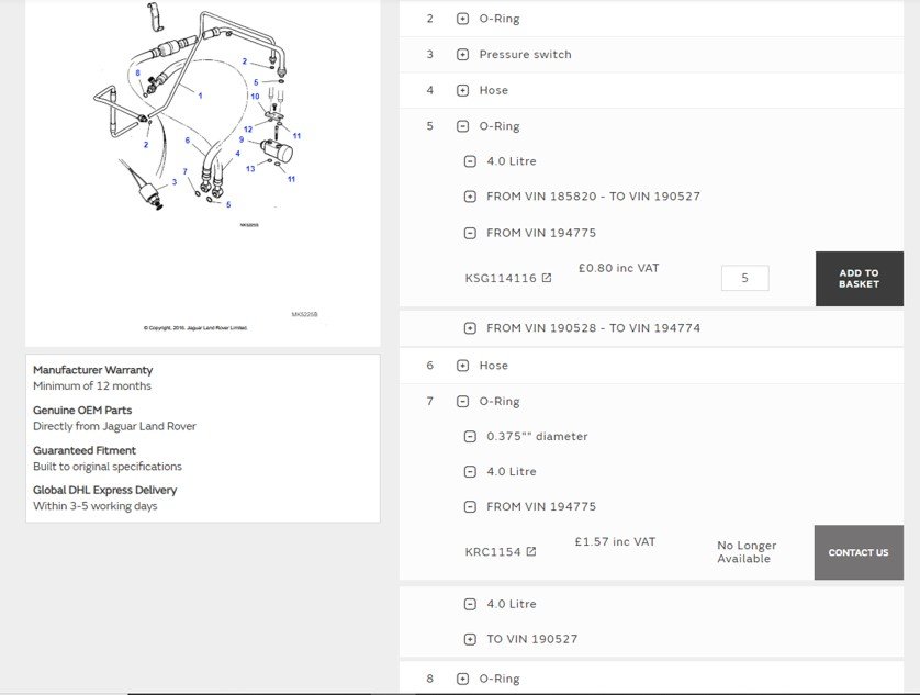

However, on the diagram of the pipes themselves, it shows additional seals on each pipe with differing part numbers - KSG11416 on one pipe, and KRC1154 on the other pipe.
So my question is: Are there two seals for each pipe? One on the pipe itself and one in the compressor rear housing? And if so, why 2 seals? Or did the seals on the back of the compressor housing disappear at the compressor changepoint leaving just the seal on the pipe? And if so, how did my dealer fit those C35864 seals some years ago? Or is the parts system just incorrect? The parts systems seems quite conflicting for an AJ16 setup VIN 196xxx
