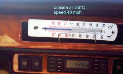

As regards performance, I've done three of these systems now and have always managed to get the output air temp from the face vents down below 4°C when in full cooling mode (image below in case this sounds like an idle boast). So while 134a may not be quite as good as R12, it should still produce a chilly blast.
