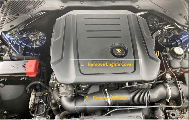

1. Detach and lift away the Engine Cover. NB. The Turbo Charger inlet casting is on the LH side of the engine as viewed and the EGR cooler is located beneath it.
2.Remove the plastic Air Duct between the Air Filter box and the Turbo Inlet casting. (There is 13mm headed bolt in the middle, a Jubilee clip with 7mm head at the Air Filter box end and a wrap around hose clamp at the Turbo end).

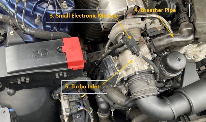

3. Disconnect the small electronic module on the top side of the Turbo inlet. LH side front of the engine as viewed. (One T30 torq screw at the top, one T15 torq screw holding a pipe connector into the Turbo inlet the at the bottom and a harness plug at the front). Leave the two pipes connected and move the module out of the way.
4. Disconnect the rubber breather hose that links the top of the Turbo inlet to the Camshaft cover. (Two 8mm headed bolts at the Turbo Inlet and a retractable collar at the Camshaft cover). Wiggle the hose free as it has a large O ring engagement flange.
5. Remove the Turbo inlet casting. (Undo the two 10mm headed screws on the top, the harness plug to the electronic module on the LH side and separate the cable harness holder and lift the casting away, again there is a O ring engagement flange to wiggle free).

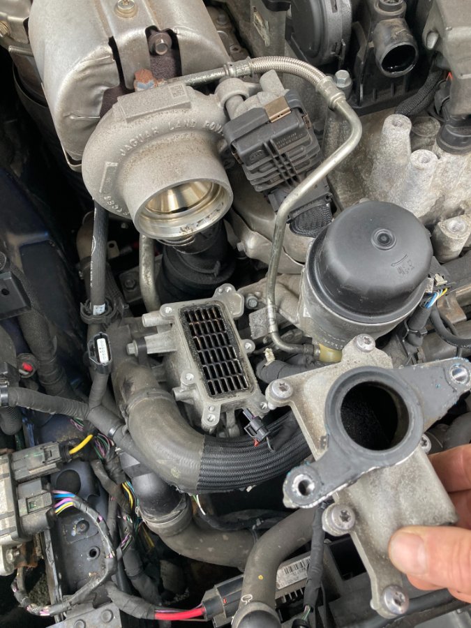

6. The EGR Cooler cover is now fully visible. Undo the six T30 torq head screws and lift the cover away with the gauze filter and gasket surround. Separate the filter and gasket and clean the Cooler cover ready for reassembly.
7. Clean the mating surface of the EGR Cooler and vacuum it out to ensure any debris is removed.
Reassembly is simply the reverse process but be very careful when tightening the screws and bolts as it will be easy to strip the threads in the aluminium components. I could not find torque specifications for the bolts and screws but would expect the six T30 torq screws to be about 8NM and considerably less for the T15 screw.
