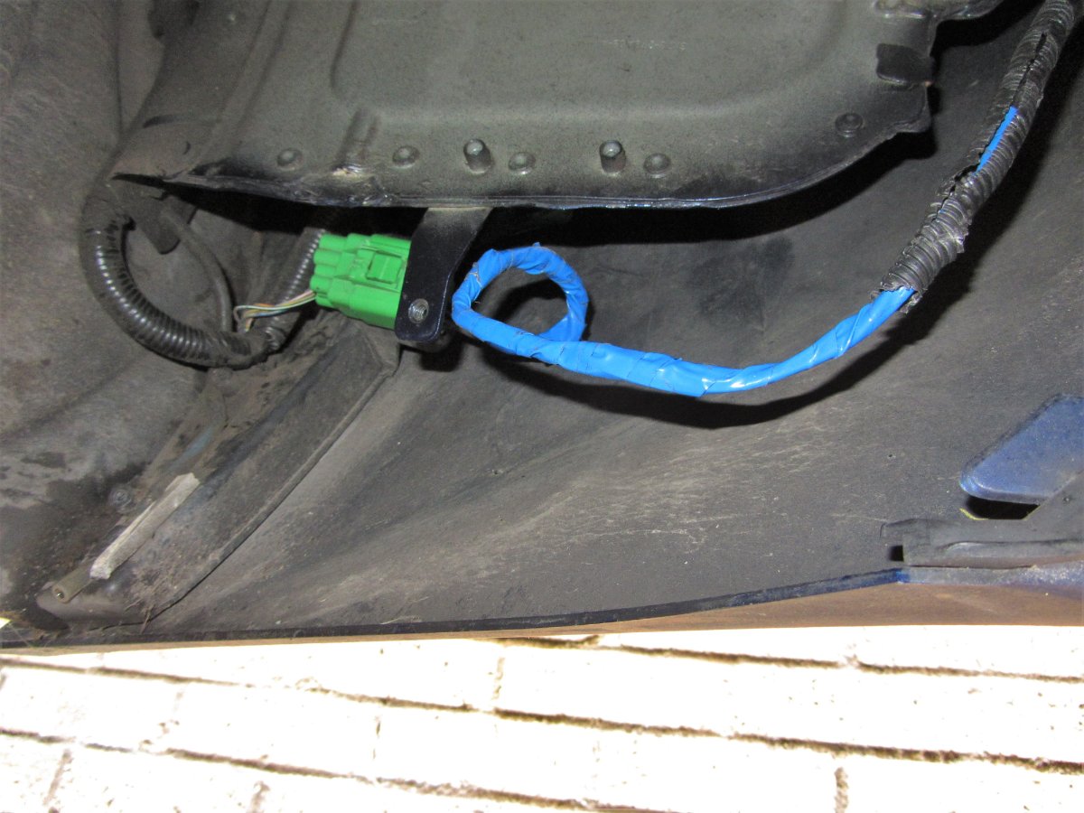

As I was not able to pin point the fault to a specific sensor I got under the car to check further. After removing a rear right hand underside protector cover I found a wiring harness that had all its six leads fractured close to its connector and two leads were actually shorted together.
I started to remove the harness but it proved difficult so I decided to repair in-situ. I separated the harness connector and carefully soldered new wire lengths on away from the car and used heat-shrink to provide insulation. I then cut back the original harness far enough so it was free of damage and chaffing and reconnected to the new leads, again using soldered joints and heat-shrink.
I reconnected the plug and checked the system. Amazingly it worked !
The repaired harness was minimum two inches longer than original. I added more insulation tape and I re-routed it so it was clear of metal edges and not under strain before putting the cover back on
