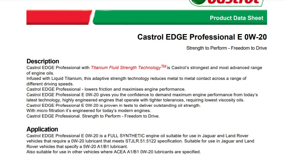

Re: Oil change
The oil spec listed by Jaguar is SAE 0W20 STJLR.51.5122, so it's as well to look for oils which comply with this standard. Mike.
Re: Oil change
Thanks Mike - again.
This one seems to tick the box.
