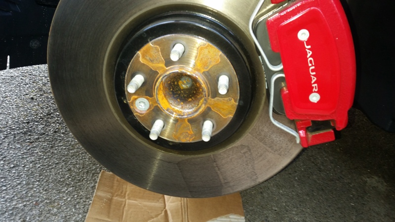

Re: XE S Arrived
Have now checked remaining wheels hubs. All have corrosion, which I've cleaned off as best I can and smeared a light film of copper grease on the mating surfaces.
The vehicle left the factory 1st week of March: Here's a pic of the front N/S hub
Mike W

Re: XE S Arrived
Mike,
Sad to see that corrosion on a brand new car. Jaguar preclude the use of grease or similar protection in numerous different locations. This causes so much extreme and unnecessary aggravation in many location around the vehicle, I just cannot understand this lack of attention to detail during the assembly process.
I am fortunate in having a vehicle lift and have been able to attend to anti - corrosive treatment from day one. Both the front and rear sub frames were heavily contaminated with weld splatter and a lousy paint finish ,really not good enough. I could produce a long list of items that required corrective actions.
Arguably , as most owners don't seem to know how to open the bonnet let alone care about the underside why bother . Providing it lasts ten years before being recycled what the Hell !!
Meanwhile , I sympathise with you
