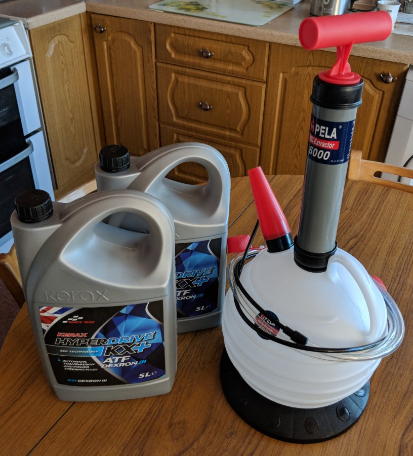

All set for a few fluid changes, all I need now is a weekend free of rain and back pain!
1995 4.0 Celebration Coupe in Sapphire
Re: Harsh Gear Changes
I did the first fluid change today and yes, it really needs doing! Second change pencilled in for tomorrow.

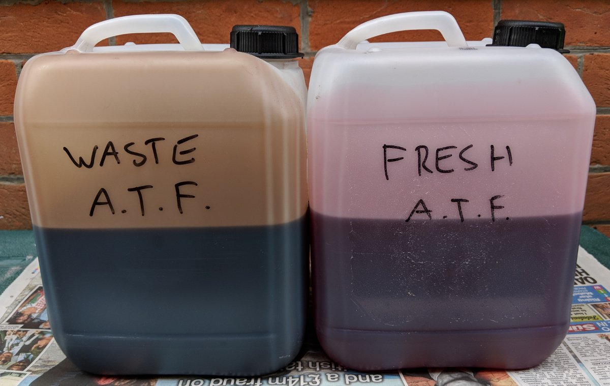

Here's the result of today's ATF change, No.4 - Still going in strawberry and coming out chocolate!
1st to 2nd can still be a little jerky but doesn't seem quite so harsh now.
Keep the changes going, Tris! Fluid is cheap!
Remember, after 4 changes, you've still got over 1/4 of the old fluid still left in there.
Good luck
Good luck
Cheers Paul, I've still got another 18 litres of fresh ATF to run through her yet!
