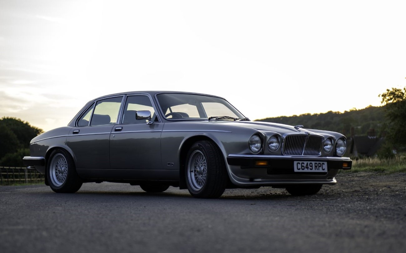

Hi guys, I have a Series III XJ V12 with a Getrag from an 85 XJS 3.6. Can someone tell me the correct part number for the speedo transducer that's fits in to the gearbox...? Or better still offer me a working example??

Hi guys, thanks for the reply, I think DAC4569 is for the V12 and 4.2 autos. These are a different diameter to the XJS manual and when you speak with these guys selling these transducers (on eBay) they can't tell you for what model its for! Just in case your interested its for this!
