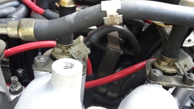

my only thoughts would be a dodgy injector loom , or a high resistance in one of the injector plugs loom, not forgetting the power resistor plug behind the right front headlight , this is known to ' go green ' raising the resistance enough to cause trouble

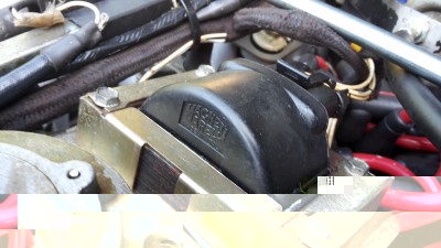

Are the two coils on the Marelli system (DAC4608) located next to each other in front of the throttle cable pulley and then the two ignition amps (DAC4607) located on the radiator cross member? Just want to be sure...

BigCatXJS - yes the 2 coils are on top of each other between the distributor and the throttle capstan and the amplifiers are mounted on the radiator cross rail.
Thanks all for your suggestions. I will report back when I've tried swapping the coils.

I tried swapping the coils to see if that made a difference or moved the issue to the other side. Apart from a moment when the car wouldn't start because I'd inadvertently swapped the 2 king leads around the coil swap made no difference.

i to messed around with the throttle linkage today
the above mentioned switch is the ' idle switch ' and reading my ROM i discovered that the switch should click as soon as the TB opens, so it seems Steves is set quite correct and mine wasn't opening soon enough , that is now rectified
i think that it just tells the ecu that the car is at idea and not to over fuel, when it clicks its telling the ecu the car is off idle and to fuel accordingly
i did notice a lag in the linkage so adjusted that up as well
my two stainless drop links with the spring clips to the fulcrum shafts on the TB seem quite worn , and these are NLA from Jaguar , though the clips are available
