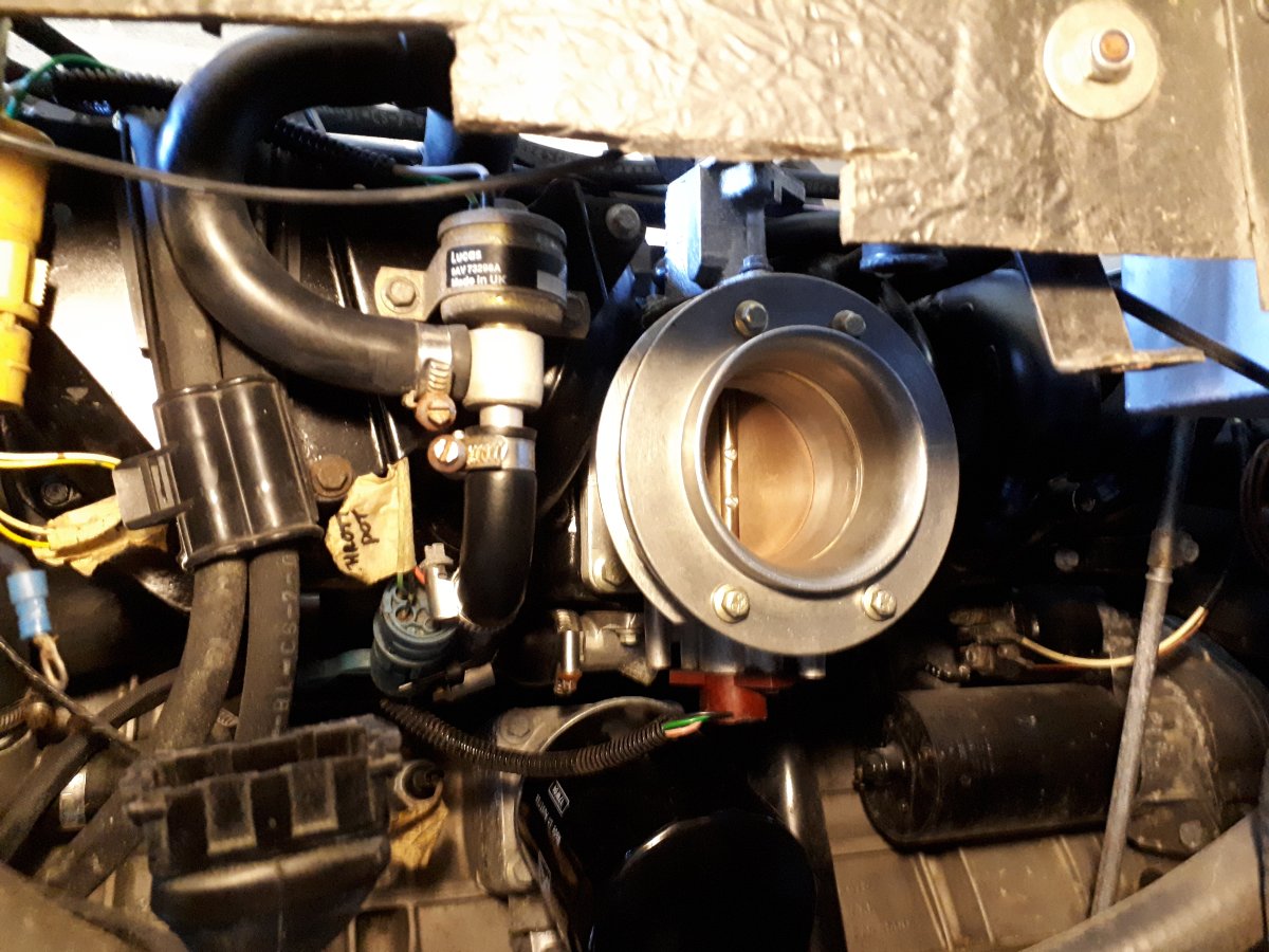

Hi all,
I followed the advice above, the throttle body was pretty clean as I cleaned it well when I built the car 3 years ago, but the air gap was a bit small so I opened that up.
The idle control valve was a bit gummy. I had not cleaned that before as I was a bit wary, not really knowing how it worked.
Following the reset instructions I started the car and it sprang to life idling up at 1600 rpm. I left it there to get fully warm. Once the temperature hit 70ish the revs dropped to around 1100.
I then tried to adjust it down to a decent idle - but enliven with the iscv fully screwed in it was still at 900 ish. So I adjusted the throttle butterfly to close up the gap a bit - reasoning that my measurement would not be that accurate.
I've ended up with the iscv about 3/4 turn from closed and idle at about 800. Although the car is probably still a bit warm so I'll give it a go tomorrow for a final adjustment.
Thanks for the help - that's one more part of the car I understand.
But - what is the unit forward of the throttle body in the air hose that feeds air to the iscv? I'd love to understand what that does.
Re: Stalls rather than idles
I think that's probably an extra air valve designed to raise the revs when there is extra load on the idling engine caused by the air conditioning compressor.
