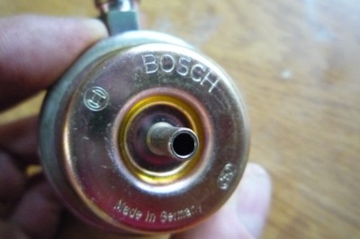

Just to bring this thread up to date - this is how the issue was finally resolved.

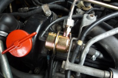

First thing I did was to try by-passing the inlet pressure valve. This made no difference so I felt that I had narrowed the issue down to the outlet pressure valve. I had changed this earlier but it was looking suspect.

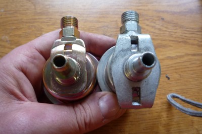

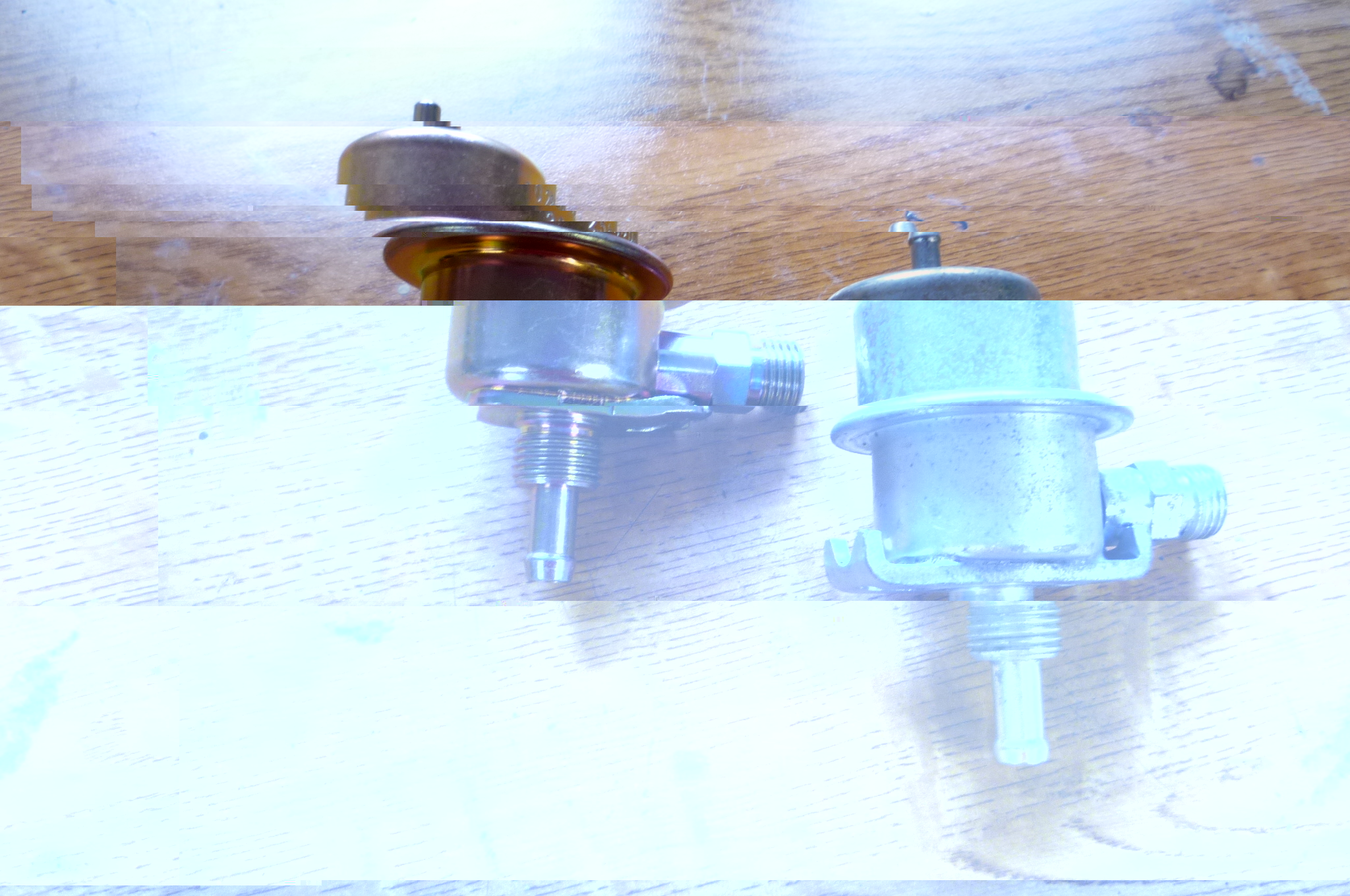

Back then I was faced with a choice of a pattern part for £36 or the genuine one for £95. Guess what I did? Well of course I congratulated myself on being so financially astute and did the obvious thing. That was now starting to look like a bad decision so I bought a genuine one Above shows the pattern part on the right and the genuine one on the left. Interestingly, the pattern part is a better physical fit as it has both of the locating lugs.

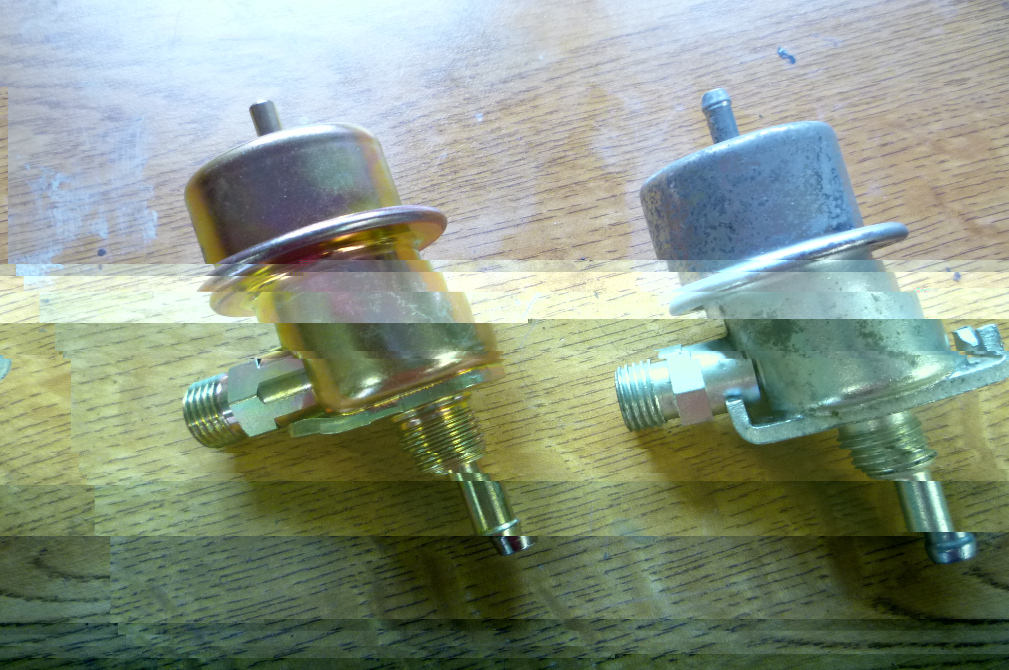

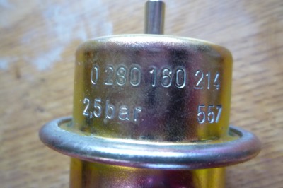

The genuine part is made by Bosch as you see below. There are no marks on the pattern part I could see to indicate who made it. The Bosch part number and rating can be seen here As you see, its rated at 2.5bar and I've already established that the pump is giving 3 bar so that appears to be correct.

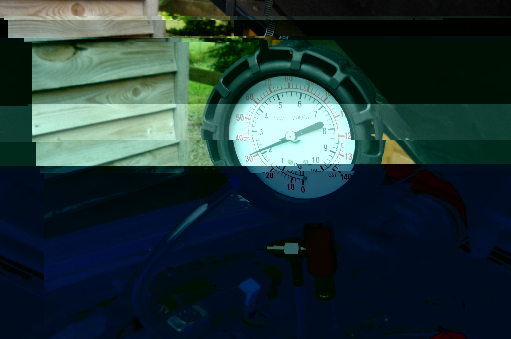

With the engine running at tickover, the pressure in the rail was about 2.25bar as below When the revs were raised the pressure in the rail decreased as it should. (the purpose of the fuel pressure regulator is to maintain a constant differential pressure between the fuel rail and the inlet manifold so that the injectors have a constant pressure gradient of 2.5 bar between inlet and outlet. It does this by means of a diaphragm and spring balanced against a vacuum pipe taken from the inlet manifold).
When the vacuum pipe is pulled off the pressure also rises as it loses its compensation.
So the moral of the story is that I fell for false economy!

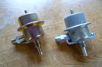

That Bosch part number in your pics is really helpful: this broadens the part search to a much wider network of parts suppliers, with the same regulator apparently used on Porsches and BMWs of the era. Best UK price I found is roughly 1/3 less than directly from Jaguar...
