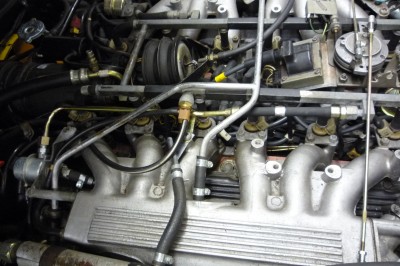

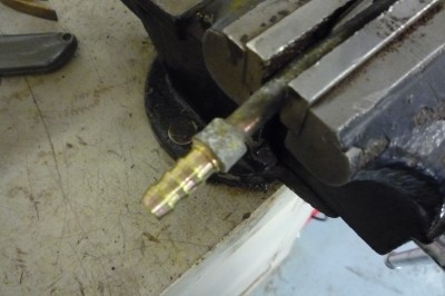

I think I've got a cunning plan for measuring the fuel pressure in the rail.
a while ago I got a new hose that goes from the rail to the outlet pressure regulator (left side). Noticed it on ebay and fitted it because the hose would be new and supple and the metal parts where shiny and new. EAC9986 is NLA from Jaguar but they do pop up now and again. As I'm a magpie, I kept the old one and I'm now going to adapt this so I can tee a connector in for a pressure gauge.
I've ordered a pressure gauge via ebay so another instalment when it arrives!

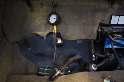

Re: Marelli V12 idle stumble
I've connected a pressure gauge into the return pipe from the fuel rail using the old pipe that I adapted earlier.
Results were :
When I turned the ignition to position 2 the pump ran for a few seconds as it should. As the pump ran the rail pressure was 2.25bar. When the pump stopped pressure dropped to 2bar and held.
When I started the engine rail pressure was about 2.25bar and held, fluttering a bit. Pulling the vacuum hose off the regulator made no difference. I let the car warm up and it idled rough with the characteristic stumble.
Next step was to put a hose clamp on the return pipe to the fuel cooler so I could adjust back pressure and increase the pressure in the rail. As it increased to about 2.5 to 3 bar the revs increased, the idle smoothed out and the exhaust smelled much cleaner.
So, fuel pressure is the issue. Both fuel pressure regulators have been changed so could the issue be the pump?
Results were :

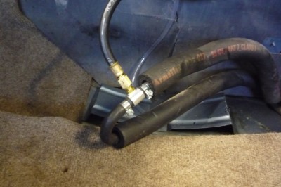

So I put the new pipe back on the car and moved to the boot.
What I decided to do was to put the gauge in where the filter would be. This showed the pump delivering a fairly steady 3 bar so it appears that my pump is healthy.
So now I'm proper confused!
Just to be clear, these are the steps that have been taken so far
The injectors have been cleaned using the Terraclean service.
The swirl pot and intake filter have been removed and cleaned
The fuel filter was renewed at last service
The throttle position switch has been checked and reset
The throttles have been checked and reset at 2 thou
My thoughts are, if the pump is delivering 3 bar to the filter then it is working fine. If there was any restriction in the fuel lines then the back pressure would be higher?
Maybe the filter is partially blocked and restricting flow? I think I'll order another one.
Or maybe the intake pressure regulator is restricting flow too much?
So I think I'll try bypassing the intake pressure regulator?
Any thoughts?
Any thoughts?
