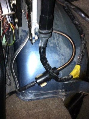

have you proved the vac pipe to the boot ecu is good ?
i have also found benefits to fit the vac reservoir next to the ecu , this holds the vac and prevents fluttering of the pressure
this is available from heritage, and is a 30 second fit , and costs about a tenner CAC4968 ( ebay )

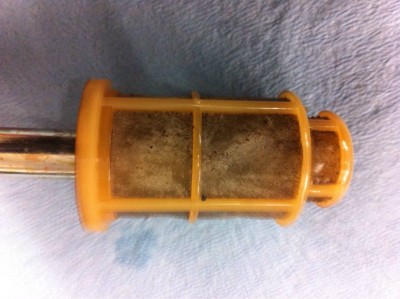

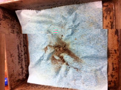

A few pictures of what came out of my swirl pot and fuel pickup. I do wonder why the filter mesh is so fine and quite how much work the inline fuel filter actually does.
Haven't had a chance to run the car properly yet - mostly because it doesn't have much fuel in it!!
Pickup filter pretty clogged even before it sucks up more of the stuff in the swirl pot
Rubbish filtered out of the fuel flushed through my swirl pot and filtered through a sheet of workshop towel
Close up of the accumulated rubbish

that filter is 100% the cause of the poor idle and lack of power , and if that much debris is on the pickup filter I would say the tank needs pulling and sealing on the inside ,
I too have wondered what the main inline fuel filter actually does, as this pickup filter protects the pump , the main filter must only be there to stop pump parts going to the engine when it implodes ?

The lack of power issue only happened once on a long steady drive and this clogging of the intake filter is undoubtedly why. As you say BB, pulling the fuel tank and flushing, sealing and possibly replacing it is now on the winter jobs list.
I haven't driven the car since flushing the swirl pot. I had intended to give it a blast this evening but the weather prevented play. I did start it up and let it warm up in the garage though. I can't say that the idle was any better.
I did check out the vacuum pipe by pulling it off near the ECU and the suction was strong so I guess the pipe is OK.
By the way, i took a picture of the vacuum reservoir we were talking about earlier just for reference for other people reading this.
